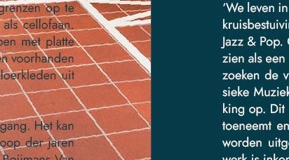

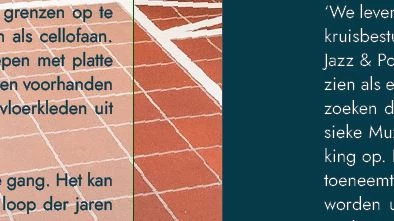

When I place a transparent rectangle behind some text, to make it more readable, the font of the text on the opposite page changes in weight.
It's not only a preview error in InDesign, because when I export it as a PDF the difference in font weight remains visible.
This is without the transparency:
This is with transparency on the left page, and the font weigth on the right page changes.
On the next spread, the font is normal again.

Alright, it seems to be an InDesign and export problem, because when exporting this with the PDF/X-4:2010 standard, the issue is gone when looking at the PDF file.
Before I exported without any standard and only changed some settings from the [High Quality Print] preset. Then the font weight was different.

I'm glad to hear the issue was resolved using the PDF/X-4:2010 standard. This preset manages transparency and color profiles more effectively, which likely fixed the font weight inconsistency.
For future reference, it's best to stick with export standards like PDF/X-4 for print-ready files to avoid such issues. If you encounter anything similar, feel free to ask anytime!
