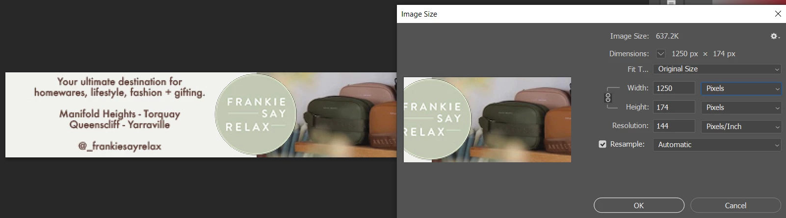

I am working on some ads for a website - the size of the file being 628 x 90px. Any time I try to export them, they come up completely blurry, however whenever I up the DPI setting, the physical size of the file becomes larger and is rejected by the website it will be advertised on. png's are saving similarly. I have not had this issue before.. I feel there might just be something simple I am missing? Thank you!

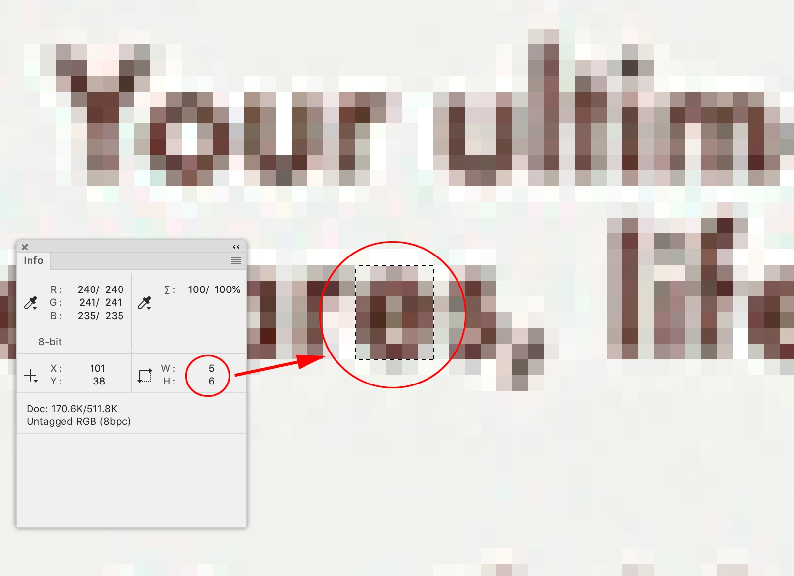

Hi James, What application would improve the rasterizing of 10px type?
Given the small pixel dimensions, the only way to affect the look of the type would be the anti-aliasing applied to the text, but that wouldn’t change the problem of drawing a lowercase e in a 5 pixel square. If I imitate @Lyndsay24130315r6dz text—10.5px Futura— in a Photoshop text layer there’s no meaningful improvement:

Hi @Lyndsay24130315r6dz , The 628 x 90 pixel dimension is too small to resolve the small text point size you are using. If I zoom in on your example set to 628 x 90px, and measure a lowercase e, its pixel dimensions are only 5px x 6px—not enough to draw a legible e. If you really are limited to the 628 x 90 pixel dimension you can’t use such a small pt/px size (10pt?) for the text.
July 20, 2023
File supplied here isn't the dimensions mentioned
An when resized it's not the right ratio
Here it is resized to the actual required size at 72ppi (I know)
rob day
July 20, 2023
Even at the provided 1250 x 174 dimension the lowercase e is being drawn at 10 x10 px—the type is just too small to be resolved in such a small pixel dimension.
July 20, 2023
If you open it up in Photoshop you will see the dimensions are off - because InDesign exports to jpeg with unusual method.
It's probably happening because the website is scaling the image, and doing a bad task of it.
Best method I have found is to export as PDF first.
Then open the PDF in Photoshop and resize to your needs.
I find this method gives the best options and results.
