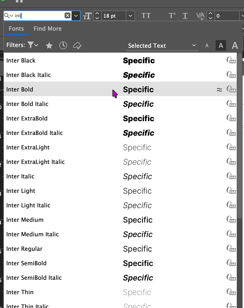

You can use the Find Font dialog box to replace fonts globally. Check update styles option if you want to make sure the original font is not used again.
See if you can select the weight from the font menu rather than the font-style menu:

Could it be a problem with v4 of Inter? What version do you have? Some say v3 is stabler than v4.
https://www.youtube.com/watch?v=_WBGIbRwYd8
Did you know that using variable weight OpenType fonts is risky? You should proceed with caution after much testing.
