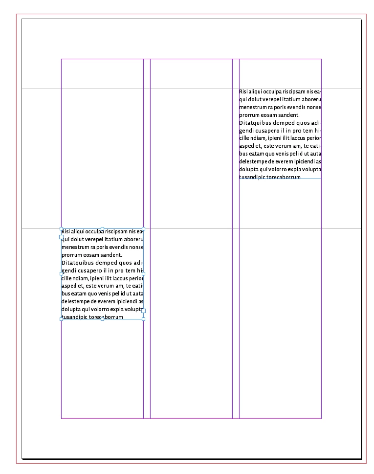

dublove
dubloveAuthor
March 28, 2021
I hope:
Align the top left corner of the text box to the left of the column it is in, and move it horizontally
Width adapts to column width.
At the same time, the height of the text box adapts to the height of the text content.
As shown in the figure below:
Thank you~
rob day
March 28, 2021

dublove
dubloveAuthor
March 27, 2021
Dear ~
I've tried the code you provided and it works, but it's still wrong.
What I want is to fit the bar in the upper left corner of the frame.
rob day
March 27, 2021
If you want this:
The code would be:
//set zero point and get selection
var zp = app.activeDocument.zeroPoint;
