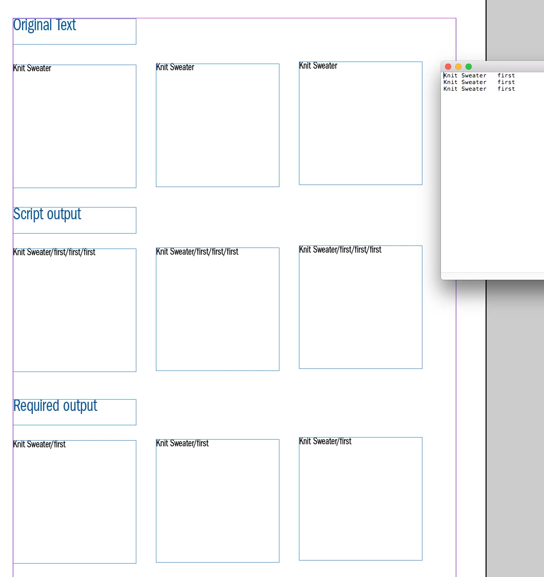

I am trying to find and replace the words from .txt file to indesign contents. If i have repeated words in .txt file the indesign also did for 3 times. The below image illustrates much better. Sorry i am improving my english to convey the requirement better.

Correct answer Jump_Over
Hello Obi,
Any suggestions please
I suggest
(keeping idea read - split - unique - change):
Array.prototype.unique = function() {
    var res = [], k, i, loop;
    loop: for (k = 0; k < this.length; k++) {
                for (i = 0; i < res.length; i++)
                    if (this == res) continue loop;
                res.push(this);
    return res;
var
    myDoc =app.documents[0],
    myFile = File.openDialog("Select a TXT file to proceed","*.txt",false),
    mySource = [], cLine, cCol1, cCol2;
if (!myFile) exit();
app.findTextPreferences = app.changeTextPreferences = null;
with (app.findChangeTextOptions){
    includeLockedLayersForFind = true;
    includeLockedStoriesForFind = true;
    includeHiddenLayers = false;
    includeMasterPages = true;
    includeFootnotes = true;
    caseSensitive = false;
    wholeWord = true;
myFile.open('r');
do
    mySource.push(myFile.readln());
    while (!myFile.eof);
myFile.close();
mySource = mySource.unique();
while (cLine = mySource.pop()) {
    cCol1 = cLine.split("\t")[0];
    cCol2 = cLine.split("\t")[1];
    app.findTextPreferences.findWhat = cCol1;
    app.changeTextPreferences.changeTo = cCol1 + "/" + cCol2;
    myDoc.changeText();

Hello Experts,
Any quick suggestions is appreciated. I hope somebody help to sort out the issue.

Hi Karthi,
I think I've understood what you mean!!
Try this:
mydoc=app.documents[0];
myfndchange();
function myfndchange(){
var myFolder = File.openDialog("Select the TXT file to Proceed",isSupportedTXT,true);
if(myFolder!=null){FilePath=decodeURI(myFolder);}
if(myFolder==null){return;}
var datafile = new File(FilePath);
datafile.open('r') ;
while (!datafile.eof){
    strLineIn = datafile.readln();
    colorArray = strLineIn.split("\t");
    var myColumn1=colorArray[0];
    var myColumn2=colorArray[1];
    var flag=0;
    x=myColumn1.split(" ");
    app.findGrepPreferences = app.findGrepPreferences = null;
    app.findGrepPreferences.findWhat = myColumn1 + "(?!/)";
    var myfound=mydoc.findGrep();
    for(i=0;i<myfound.length;i++){
        if(myfound.words.length===x.length){
            app.changeGrepPreferences.changeTo  = myColumn1+"/"+myColumn2;
            myfound.changeGrep()
function isSupportedTXT(file) {
try {
if (file instanceof Folder)
return true;
else
return file.name.match(/\.txt$/i) != null;
} catch (e) {
alert("Error in isSupported method: " + e);
