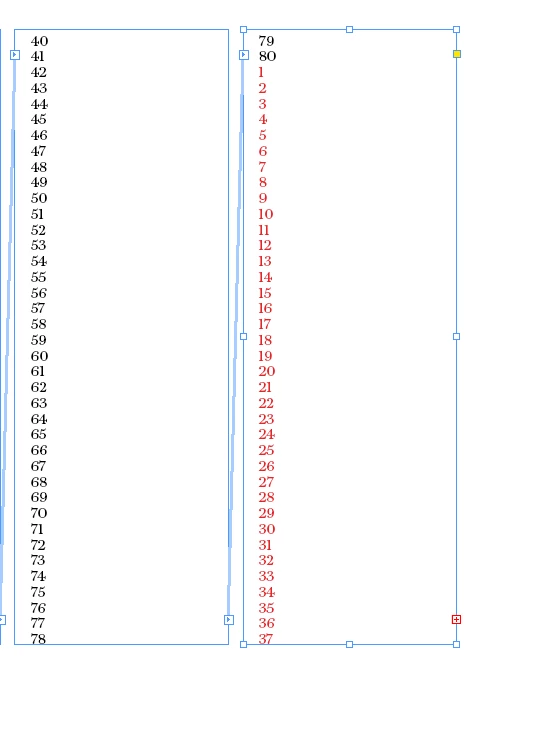

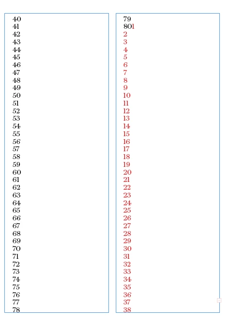

the below script automatically threads a selection of unthreaded text frames left to right
but I notice that the copy from one frame when threaded is direcly against the copy in the previous frame.
I am not sure of the best way to prevent this.
The left image is what the script does but i would prefer for it to do what is happening on the right
Any suggestions for this issues would be great
Thank you
Smyth

Sep 7, 2024 9:20 PM UTC
Thank you for the advice, I tried to recreate the issue above  - which occured both using the script and manually - however I was unable to recreate it. This is a good thing ---- it seems it works.
Regarding the comment you mentioned, it was from an earlier version and can be ignored.
