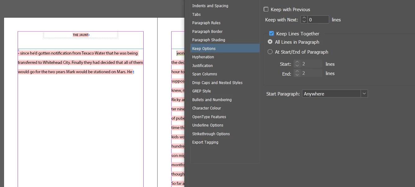

I'm currently working on a final, that being working 3-4 short stories into InDesign and printing it out to create a physical book. In my current InDesign file, I usually press enter to create a new paragraph (in this specific case to indicate when a different character is speaking), but every time I do so the text jumps to the next page? I checked in a different file that I had and the page-jumping doesn't happen. Could it be because of something I had done in my paragraph styles? I'm also including my InDesign file so someone could get more hands-on with helping.

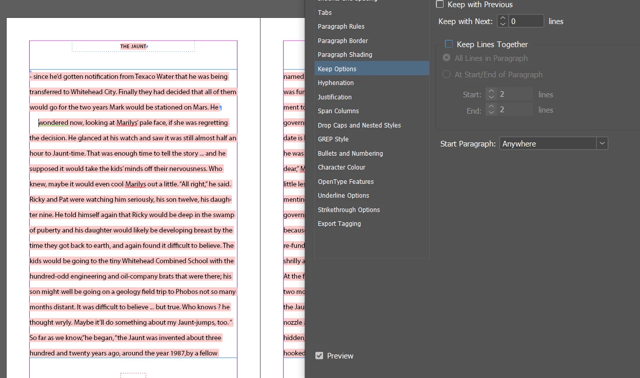

You have the paragraph style set to keep all lines of a paragraph together
When you turn this off the lines snap back.

I think I figured it out. I had to unlink my pages so I could have the proper indents for dialogue. It may not be the best solution that I know of, but it works for me.

Well, if this happens again in the future, I think Eugene Tyson is on the right track that it looks like a side effect of the way Keep Options is set up for a paragraph style, probably Keep Lines Together.
It’s important to understand the root causes so that workarounds aren’t needed, because having to do workarounds like unlinking frames might make other features less useful than they’re supposed to be.
