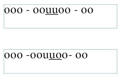

Peter Kahrel
May 19, 2022
Well. . . Before and after:
Peter Kahrel
Peter KahrelCommunity ExpertCorrect answer
