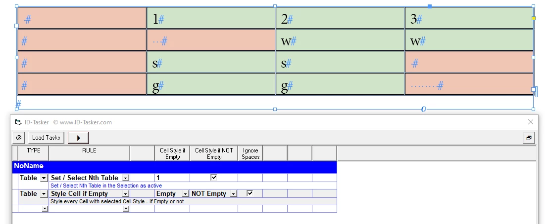

If you work on a PC - you don't need a dedicated script, you could use free version of my ID-Tasker and with few simple Rules build a Task that will do it for you. Then you can easily modify those Rules to get a different result.
In fact, you would need only one Rule:

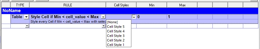

There are also different rules if you want to process only specific Range of Cells, Rows or Columns.
Robert at ID-Tasker
August 21, 2023
Fresh of the press - and still free:
First Rule is to let ID-Tasker know which Table should be processed - it checks what is selected and is pretty flexible.
Of course you can select "empty" Style on the list - if Cells should't be styled / modified.
