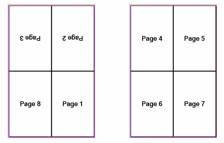

Can anyone point me in the direction to CLEAR instructions re: how to set up the layout for a French fold brochure in InDesign, i.e., an 11 x 17 document that will be folded once vertically and once horizontally to create an 8.5 x 5.5" final product?  I've found downloadable templates on-line, but confess it's not clear to me how I load those into InDesign (and they all have the waterwark/logo of the printing company in question). The one article I found on-line wasn't clear.  I found an excellent tutorial re: trifold brochure design, but couldn't find anything similar for French fold.  I'm an InDesign beginner (so you might say I have no business trying to do this!), but I have some time to devote to this.  Thanks for any help...

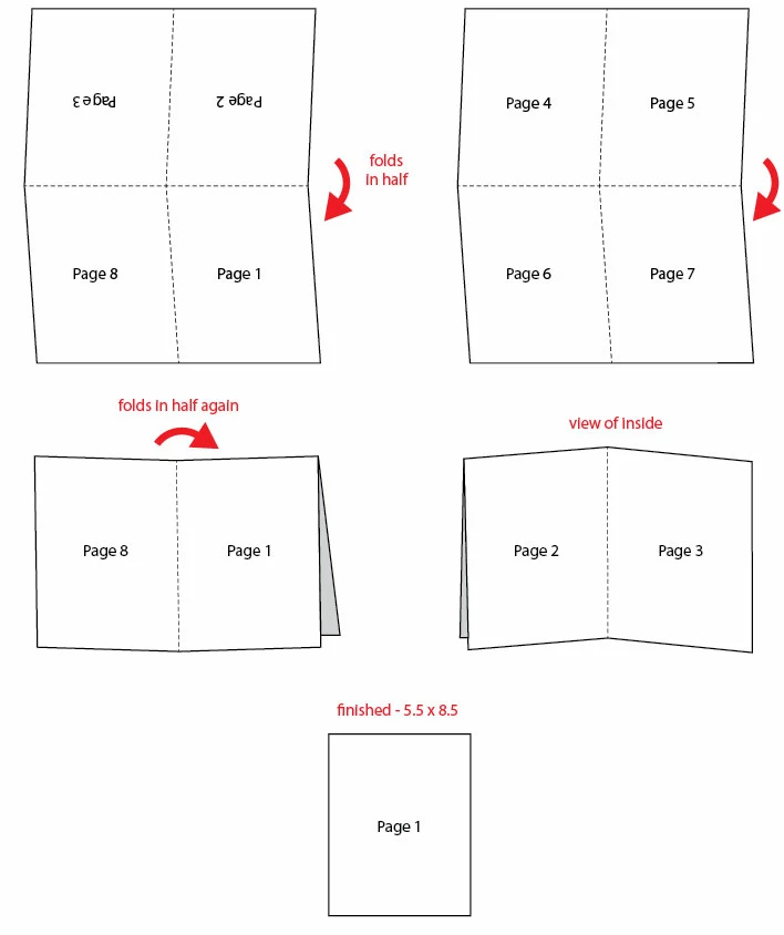

Correct answer Jeffrey_Smith
The below image shows the fold assembly

You can do this in basically 2 methods.
Method 1: One Indesign document: 11 x 17, 2 pages - front and back, guides created for the four quarters. One drawback, from example, pages 2 and 3 are rotated 180°, however you can rotate view when working on these pages of project.
Method 2: Two Indesign documents. First document used for content creation: 5.5 x 8.5, 8 pages for all quarters of finished piece, orientation normal. Second document used for final assembly: 11 x 17, 2 pages - with content placeholders for each quarter.  This will require export of first doc, and then placed into second document. Rotate pages 2 and 3, and also consider bleed of content.
Jeffrey_SmithCommunity ExpertCorrect answer
September 13, 2017
