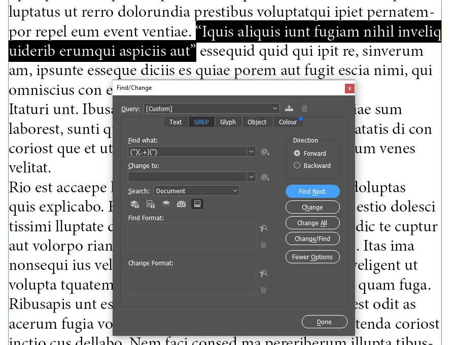

I would like to create a GREP for finding and changing
a whole sentence within quotation marks.
I have only found the GREP for a single word  ‭(")(‬\w‭+)(")‬
Anyone has the answer?
again, for a whole sentence
Thanks so much
Keren

Peter Kahrel
January 2, 2024
The parentheses around the quotes aren't necessary, and instead of .+ you need .+?
Without the question mark you match from the first quote in the text to the last one, skipping every quote inbetween -- i.e. Grep is greedy. The question mark avoids that.

You would then use a lookbehind and a lookahead:
"\K.+?(?=")
This matches everthing between quotes but the format set in the Change format panel is applied only to whatever matches \.+?, not the quotes.

I'm not sure if it's just this forum or there is something "extra" in the GREP phrase you are using - and pasted here - but there are TWO extra hidden characters - "?":
This is my GREP expression - 3rd line:
Peter Kahrel
January 2, 2024
You didn't accidentally enter the Grep expression in the Text tab, did you? Please check.
January 2, 2024
yes, in the GREP.
we got it...
Thanks!

Use
to include the quotes. If you want the sentence (whatever that means) without the quotes, use
"\K.+?(?=")
January 2, 2024
Thank you,
I tried these but they are not finding anything...
GREP GODS, I wonder what is the magic equation??

I'm not GREP guru and away from my computer right now - but maybe instead of (\w+) - (.+) will work?
"." means "any character".
But "sentence" is a bit tricky beast - as it can end with "?!.".
Also, you can have "." in the middle - like "i.e." or "e.g." or "J. Doe".
Or by "sentence" you just mean bunch of characters between quotation marks?
January 2, 2024
Or by "sentence" you just mean bunch of characters between quotation marks?  YES
(I tried (.+) - it does not work)
Thanks

Works for me:
Can you upload sample INDD file?
