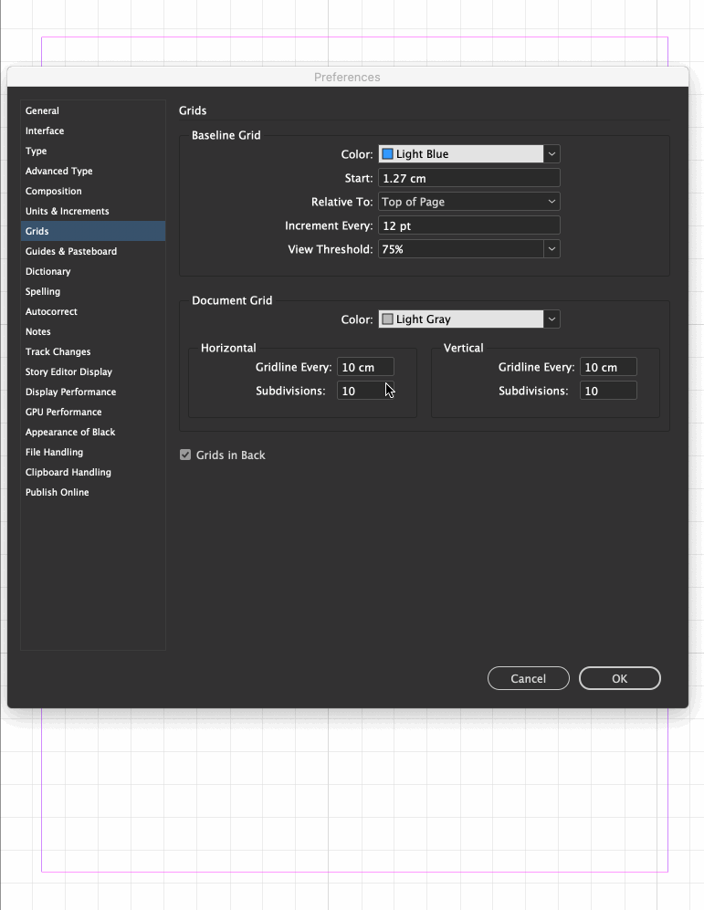

    Mar 8, 2020 9:03 PM UTC
    In an ideal world, I'd have a grid of 1cm squares, and when i draw anything, or move anything at all, it will only snap to these squares.
    So how about defining a grid of 10 cm, with 10 subdivisions, and then set the snap to zone to something larger, like 20 px? With those settings, no matter how sloppy I am, my objects are snapping to the grid.
    ~Barb
    Walrus80Author
    Mar 9, 2020 12:11 PM UTC
    Thanks so much for your reply barb. It seems to work great for rectangles, just not the line tool.
    The line took seems to almost snap if you're close to a grid point, but is easy to click randomly and it not snap. Is there a way to correct this?
    Also, please could you give me a simple explanation of what the snap to zone is all about and how you know what to set it to?
