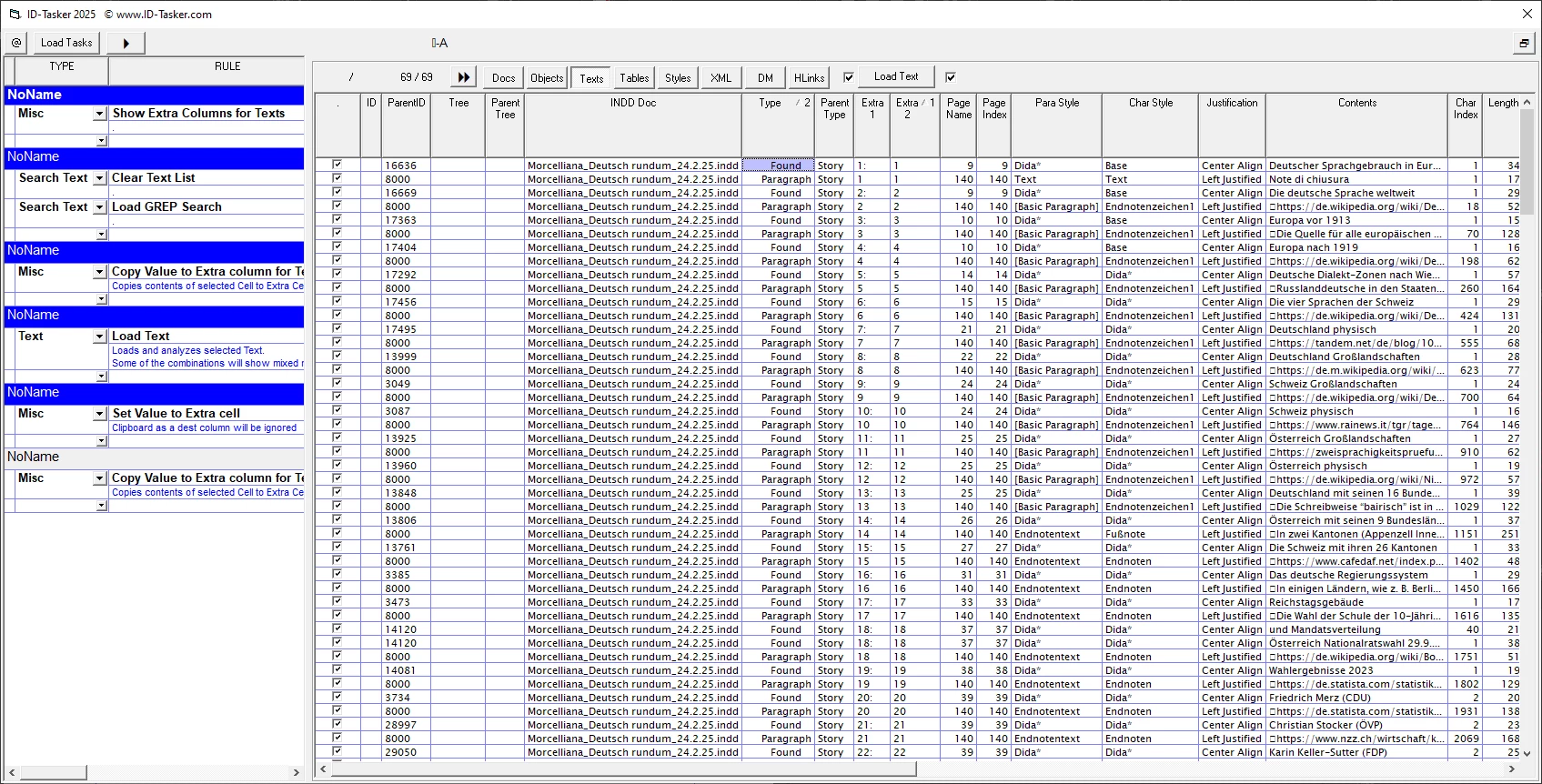

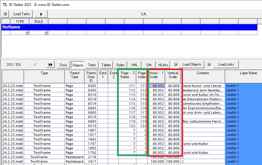

By the way, this time also I have some good advice: my editor's graphic designer has sent me two screenshots made with ID Tasker for Indesign, must be a great tool as far as he tells me and I can understand (see pictures attached).

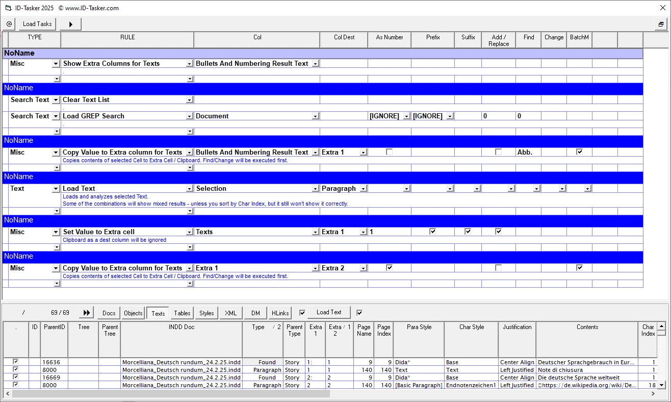

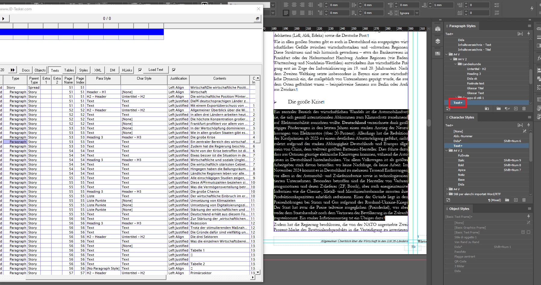

Here is a little simulation - as I don't have links.
First, I've downloaded image descriptions - like this one:
Then, I've loaded Endnotes Story - as a sample.
Then made few extra steps - extracting numbers from the "Bullets and Numbering" properties of the found results and converted to numbers. Plus added numbers to Paragraphs from ENDnotes Story (but I forgot to remove Title of the Endnotes Story so everything is shifted by 1).
Then, sorted by those numbers  - "EXTRA 2" + "TYPE" columns - so they'll be nicely interleaved:
All of the above - can be done as a single Task - it was just easier for testing - so one click instead of 6x separate.
Now it's just a case of creating a "report".
IDT isn't free - but anyone can test full version for free for a few days - just ask 😉
Any extra functionality - will be added FoC.

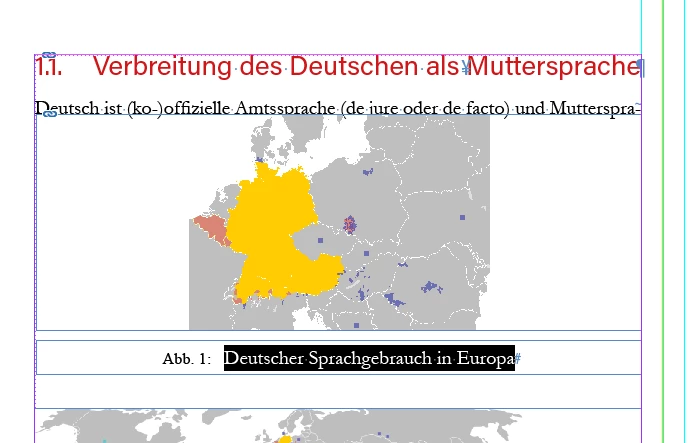

Don't enter these information in an Excel ist. Enter it in the meta information of the image. You can do it in their programs, but it is easier to do in Bridge.
You can draw these caption from the images when you place them. With the paragraph numbering you can number it. From those informtion you can create a toc based on these paragraphs.
