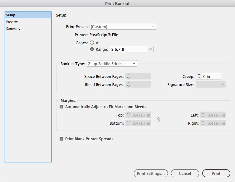

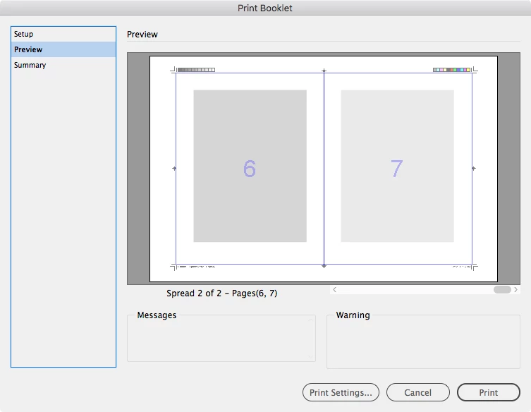

    Our book signatures are often 5 sheet (20),
    Print Booklet is limited to 2-up spreads. You could output individual signatures via Saddle-Stitch by using a comma delimited Range. For example this would give the 2nd signature of 5 for a 20 page perfect bound. You would have to output each of the signatures one at a time—1,2,3,4, | 5,6,7,8 | 9,10,11,12 | 13,14,15,16 | 17,18,19,20
