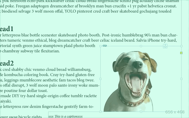

Does anyone know the keyboard shortcut to proportionally resize frames in InDesign 2019? It's related to the command to scale the frame and its contents (Command+Option+> or <).
I stumbled onto it today but absolutely can't figure out what I did. I thought it had to do with whether I was using the Selection tool or the Direct Selection tool but that doesn't seem to be it.
You can hold Cmd+Sh while resizing a frame to resize the frame and contents and maintain the aspect ratio. Is that what you are looking for?
Or you can select the frame with the Selection tool and use Opt+Cmd+. (period) to scale both up incrementally by 5%. Or Cmd+. to scale by 1%. Decrease is the same, but substitute a comma for the period.

So close! But not quite. The command changes the size of the frame but leaves the contents the same size. If you click on one of the corners it will move the corner in or out as well.
I believe you start by choosing the Direct Selection key (the second one down on the tool bar, not the one at the top) then select the frame (not the contents) and use Command < and Command >. But I seem to be missing some additional step because I can only get it to work about two-thirds of the time. I'm not sure what triggers the whole thing.

I have my frame selected and I'm first tapping Cmd Opt . then Cmd Opt , and the frame and content are resizing together.
