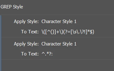

You can do it with a Nested Style (file attached) but it's heavily rule based - so the structure needs to remain the same in terms of brackets and colons - as I based the style on through 1 : which makes it work
You could do with Combo Nested Style and GREP Style
Your nested style looks like this
And the GREP Style looks like this
\(([^()]+)\)\s*$
Attached file combo nested grep style
Or do it all as a single Grep Style
This is a greedy grep and not working
\(([^()]+)\)\s*$|^.+?\:
Or as separate GREP styles
First part of sentence
Last part of sentence in brackets
\(([^()]+)\)\s*$
Best to do as Nested Style and Grep combo in my opinion
You can use 2 greps in the one style
Achieves the same thing

Bedazzled532
May 11, 2025 7:14 AM UTC
@Eugene Tyson Thanks for the codes. It worked.
