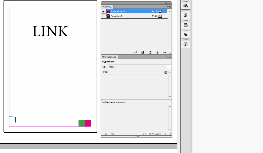

I have no problem with exporting to Interactive...
Don't you see the drop-down menu as in the example below?

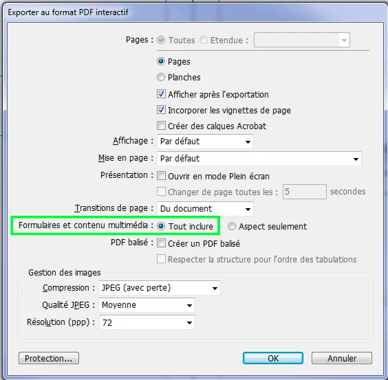

If you export as interactive PDF, buttons and hyperlinks should be maintained.
If they are not, make sure Forms And Media option is set as Include All.

Hmmm...
