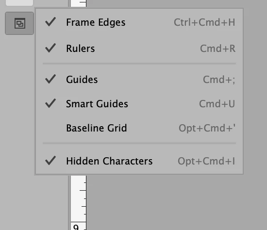

Steve Werner
January 5, 2023
I agree with Barb. When working with type, it's a good practice to always turn on Hidden Characters so you can view the hard returns which, as she says, can carry a different format that the rest of the text on the line.
The easiest way to turn on Hidden Characters is from the menu at the bottom of the tools;
