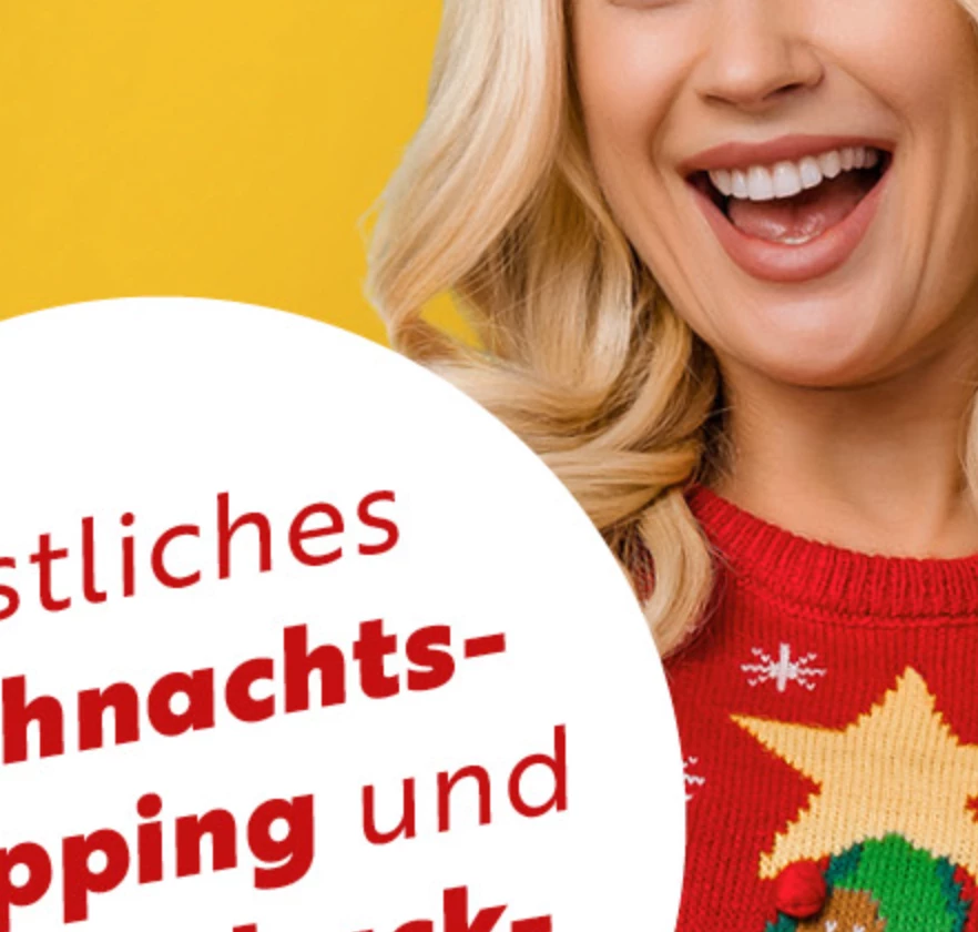

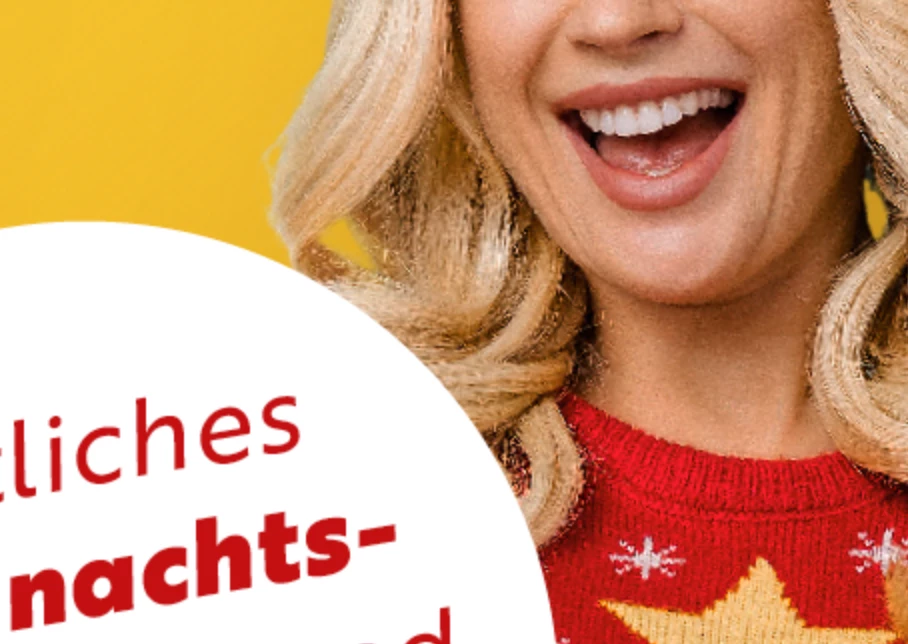

After recently updating to InDesign 2026 I now noticed, that PNG exports look horrible. Vectorized elements like path-shapes or fonts export totally fine, only the images get messed up.
JPG:
PNG:
The PNG and JPG ofcourse have the same dimensions, resolution and dpi. Changing the PNG-Quality or turning the transparency on or off does nothing. Turning off "smooth edges" only makes it worse.
To my eye it seems like InDesign is rendering out the image in a lower resolution than the rest... It also looks a bit like the preview InDesign generates when you place the image in the document. (I even tried exporting with setting the placed images preview quality to the high setting, but nothing changes in the export.)
