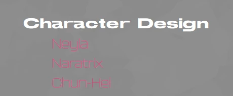

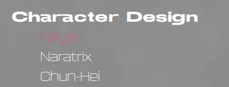

I'm making a summary in InDesign and i had the GREAT idea to make it interactive :). So i did all the button with a normal / hover / click state for every chapter that i needed, and it works fine it goes to the right page etc.
BUT if you move too fast (or not fast enough??) it lags and sticks to a state and doens't go back until you hover on it, or click again. (I'll leave an exemple of what i mean after)
Is there any way to make it lighter maybe? Or maybe less laggy 😞
  How is it normaly.
How it should work and look like when you hover one.
How it look likes when it lag :c
