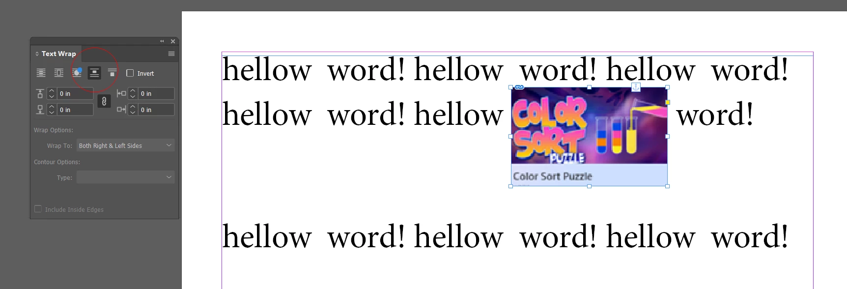

When inserting an inline graphic into the middle of a text line, by default, the bottom of the graphic's frame aligns with the baseline of the line, as shown in Figure 1. However, there are cases where we don't want it to align with the baseline. For instance, we might want the graphic frame to offset downward by 20pt, as shown in Figure 2.

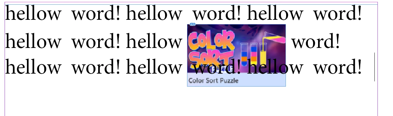

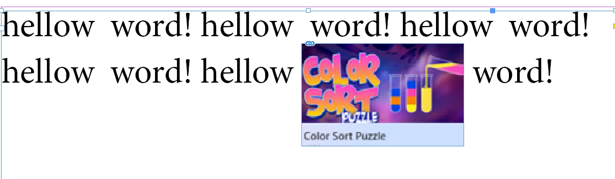

This can be achieved by using void IAnchoredObjectData::SetYOffset(PMReal yoffset). However, after applying this offset, the graphic overlaps with the next line of text.  as shown in Figure 3.To avoid this, we can apply text wrap to the inline object so that the next line of text moves down automatically, as shown in Figure 4.

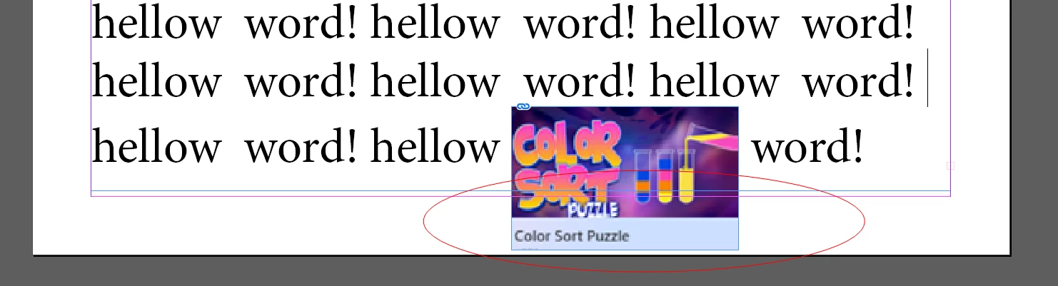

The problem arises when the inline object is in the last line of a text frame. In this case, the graphic moves out of the frame instead of pushing the line to the next page when there isn’t enough space, as shown in Figure 5.

Robert at ID-Tasker
Dec 7, 2024 2:28 PM UTC
Leading - of the parent character, and your object should rather be InLine - not Anchored.
lyj2871Author
Dec 8, 2024 6:59 AM UTC
Yes, this is indeed an inline object. Changing the leading does not achieve the desired effect. Additionally, InDesign has two modes of leading calculation. For the Adobe World-Ready Paragraph Composer or Adobe Paragraph Composer, increasing the leading enlarges the space above the baseline of the current line. For the Adobe CJK Paragraph Composer, increasing the leading enlarges the space below the baseline of the current line. If it is the last line in the current text frame, changing the leading will have no effect
