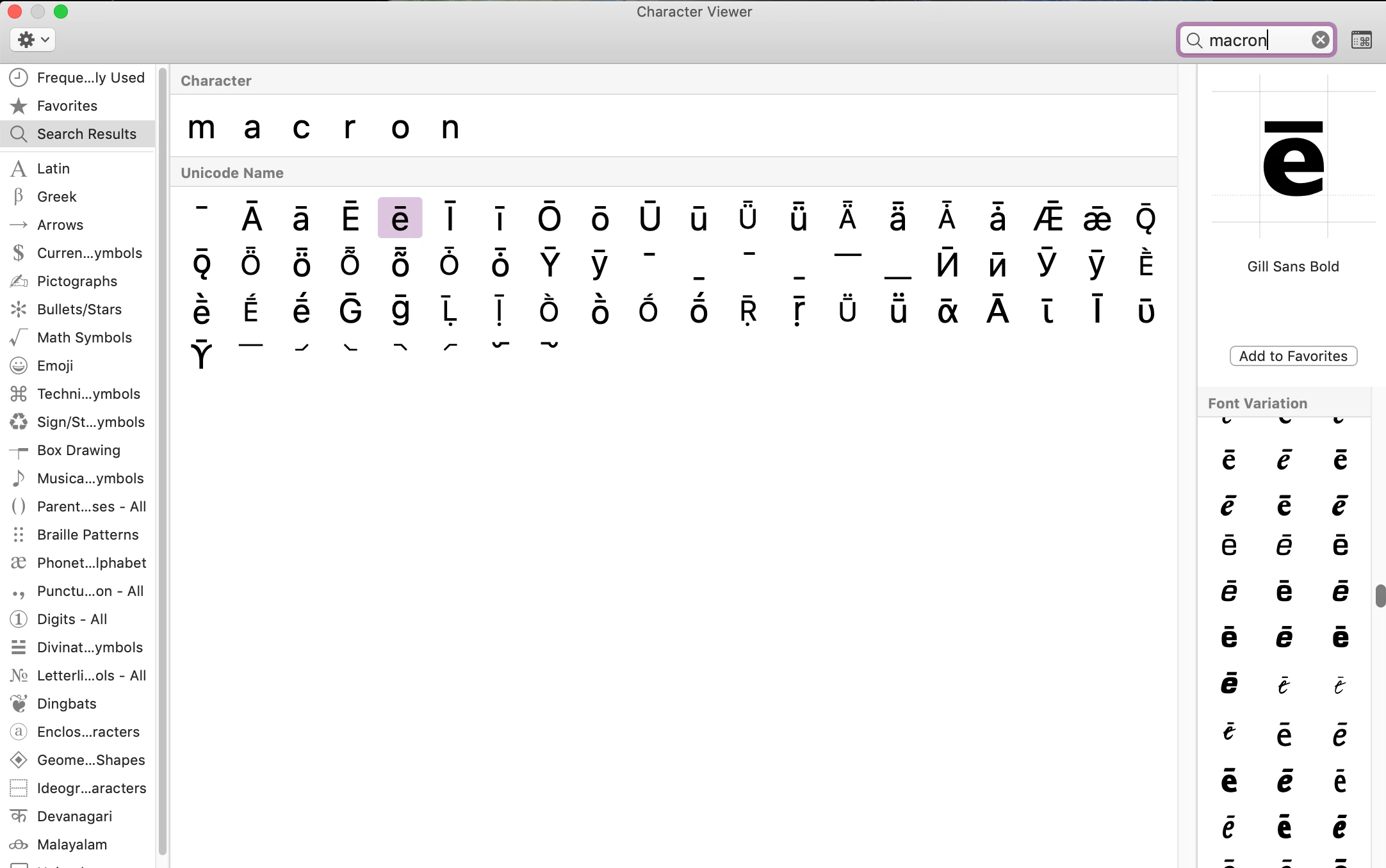

Aloha,
Just finishing a book in InDesign. I place the ‘okina as I write and then go back at the end and add the kahako. Since the book is in English this is not  monumental job.
Parameters are:
SYSTEM: OS 10.12.5
PROGRAM: InDesign CS4
TYPEFACE: Bookman Old Style
MISC: Hawaiian Flag Keyboard selected
When I go to add the kahako in Kalakaua, for example, I hit option A and instead of diacritical I get a pink box.
I searched under GLYPHS and no macron/kahako exists.
Any thoughts of how to accomplish this?
Mac
    Correct answer Steve Werner
    Look for fonts with a macron for certain letters as shown below:
    Steve Werner
    October 19, 2018
    You need to find a font which contains that glyph.
    On a Mac, you can use the Character Viewer to find fonts which contain a particular glyph.
    I wrote about this a couple years ago:
    https://indesignsecrets.com/find-font-glyph.php
    Steve Werner
    Steve WernerCommunity ExpertCorrect answer
    October 19, 2018
