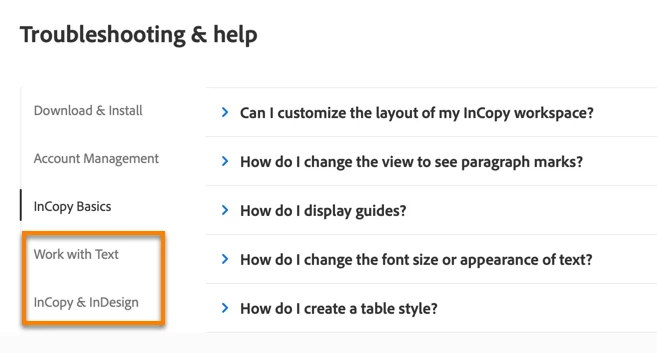

You can sign up for a free 30-day trial at LinkedIn. That's going be the most efficient way to get up and running on this workflow. If that's not an option for you for some reason, and you don't want to pay for a single month, there are links on this page that you can work through.
—https://helpx.adobe.com/support/incopy.html

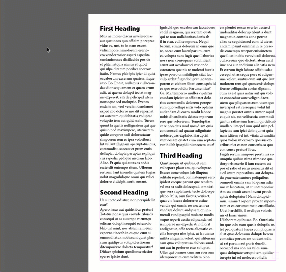

Jul 8, 2024 1:42 PM UTC
There are a few ways to add column breaks. Here's a demo of @Willi Adelberger's suggestion:

Jul 15, 2024 4:31 AM UTC
Yes, that's what I tried, but look what happens!
The 'directions' style is what I want on the next column.

Jul 15, 2024 6:20 PM UTC
It sounds as if the Keep Options setting is cascading to child styles, such as your body text. You need to break that chain.
One way is to set the "Break to Next Column" in the heading. All the text will break to next pages, or into overset text. Now work down your other styles and set the keep options to "Anywhere" — at some point you'll have that cascade down other styles and make the job easier.
As a fundamental design point, you should never have headings and body styles cascade ("Based On") from each other. Create a base body style that is based on "No Paragraph Style," and use it as the parent for all your body variations. Then create a base Heading 1 (or equivalent), also from "No Paragraph Style," and then create all similar headings as children of that.
Using cascading styles and settings is a very efficient practice — but not if you have settings you want on heads cascading to body styles, or captions, or cell text, or any of the vice-versa. Keep your hierarchy of styles organized.
