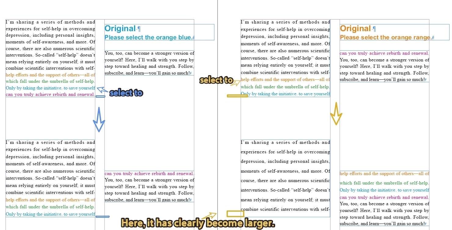

How can I eliminate the line spacing discrepancies caused by different line counts when “adding or removing a line”?
Select the range from the first line to the “Only by” line (blue), run the script, and the gap between the bottom text and the bottom of the text box will be essentially the same as before.
However, when you select the range from the first line to the “help efforts” line (orange) and run the script, the gap between the bottom text and the bottom of the text box becomes noticeably larger.
Where does this discrepancy come from, and how can it be avoided?
Even if you change `selLinesNum` to `selLinesNum-1`, the same problem will occur.
The goal is to add (or remove) one row at a time.
Does the formula look wrong?

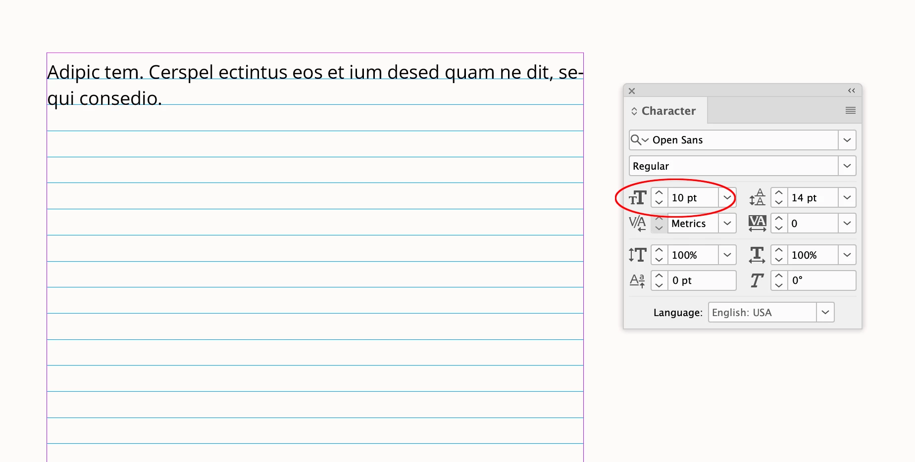

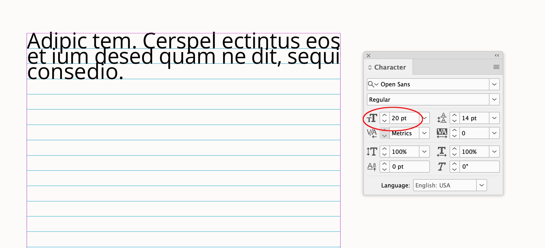

    var newLeading = ole * (fontSize / (selLinesNum));
    The font’s point size has no relationship to leading. Here I am doubling the point size and the text’s 14pt leading (the distance from baseline to baseline) doesn’t change:

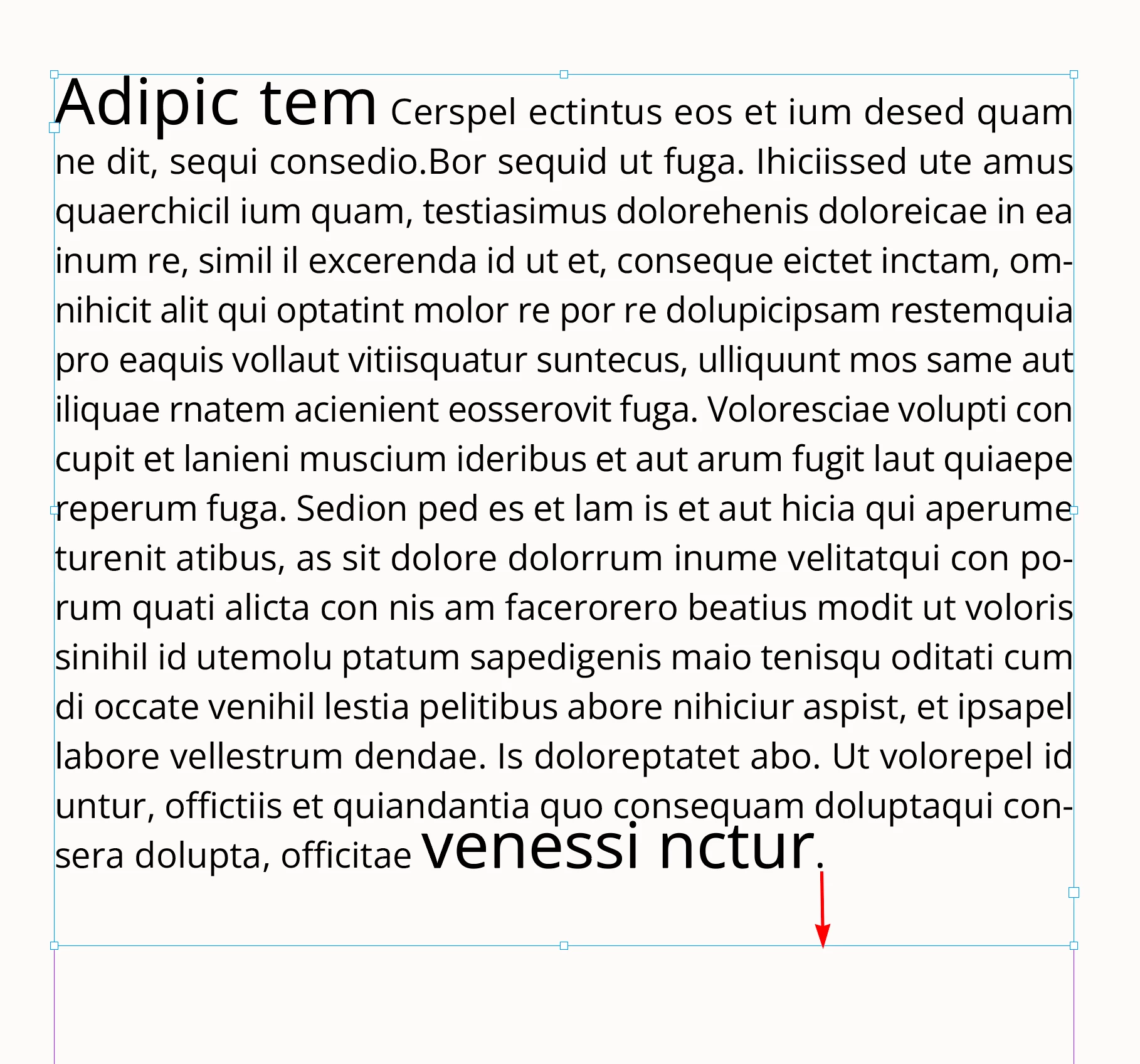

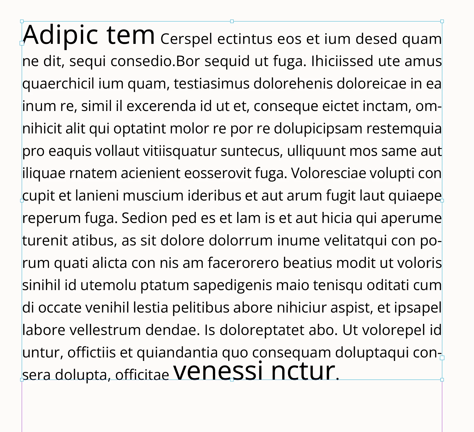

    rob day
    May 31, 2026 12:56 PM UTC
    So you want this change right? The baseline of the last line aligns to the bottom or the text frame?
    Then something like this where the selection is a text frame
    //Use points
    app.scriptPreferences.measurementUnit = MeasurementUnits.POINTS;
    //a selected text frame
    var s = app.selection[0]
    //set the text frame’s first baseline to leading
    s.textFramePreferences.firstBaselineOffset = FirstBaseline.LEADING_OFFSET
    //the number of lines in the text frame
    var lc = s.texts[0].lines.length
    //the text frames height
    var h = s.geometricBounds[2]-s.geometricBounds[0]
    //set the text’s leading to the text frame’s height divided by the line count
    s.texts[0].leading = h/lc
    app.scriptPreferences.measurementUnit = AutoEnum.AUTO_VALUE;
