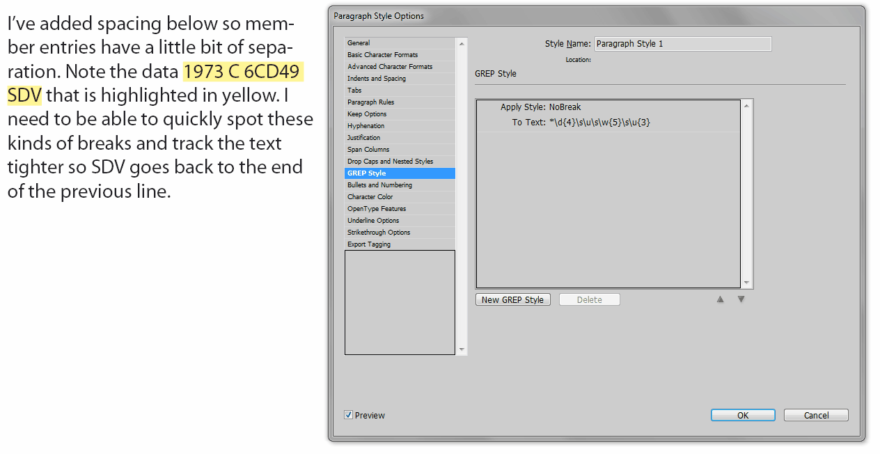

    Very interesting. Won't you mind to be a bit more specific on this? Regex offered works on sequences which meet this pattern:
    four digits - space - upper case letter - space - five characters (letters or digits) - space - three upper case letters.
    That said, like your provided sample: 1973 C 6CD49 SDV
    Include this in your Para style, set to apply Char style with nobreak enabled.
    What's wrong here?

    The sample data I supplied is not all the same length. The data refers to Cadillacs, and the body style number was really long in the 1950s, got shorter in the 1970s as you saw in the sample, and it's even shorter today. So, the lines I'm dealing with do not all have the same number of characters.
    At least dropping the C solves a lot of the problem. I sure appreciate everyone's help!

    The data is not hyphenated - it's a break between words. I'm attaching a screen shot as an example.
    Each member's name/address/city/state/phone number/e-mail address data has a soft return at the end of each line except for the last line. I've added spacing below so member entries have a little bit of separation.
    Note the data 1973 C 6CD49 SDV that is highlighted in yellow. I need to be able to quickly spot these kinds of breaks and track the text tighter so SDV goes back to the end of the previous line. Thank you in advance.
