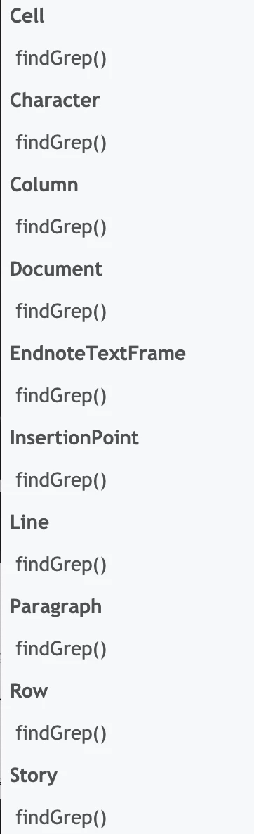

There are plenty other objects to ask. While Peter suggested to step up to the parentStory e.g. if you're coming from a selection, you can also target the entire document, or anything in between.

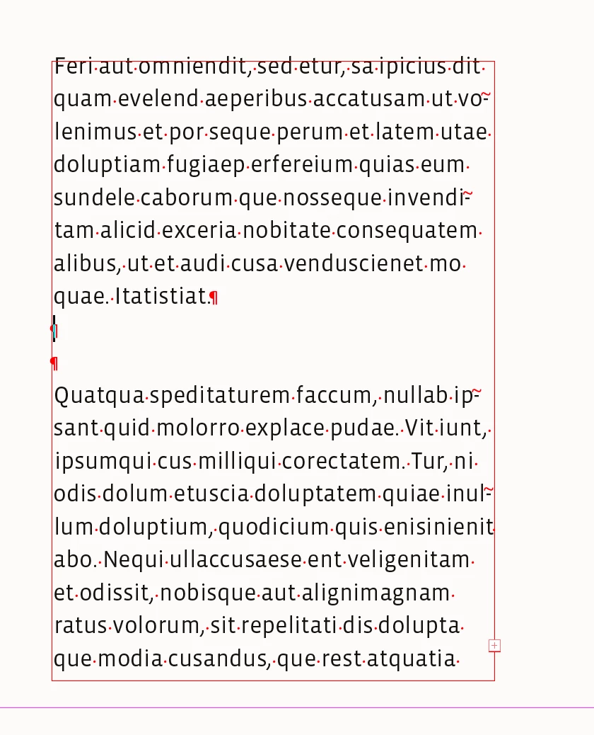

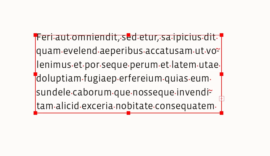

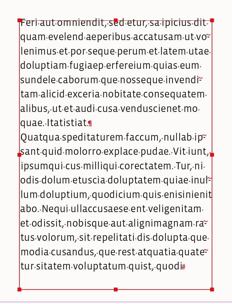

Maye try the changeGrep() function? That works for me—this removes multiple returns even when they are in overflow text:
Overflow text on run
You need to escape  "\" try this "\\"
//grepSearch("\\{\\{[^:]*\\:[^}]*\\}\\}", "/\\{\\{([^}]*)\\}\\}/g");
grepSearch("\\r+", "\\r");

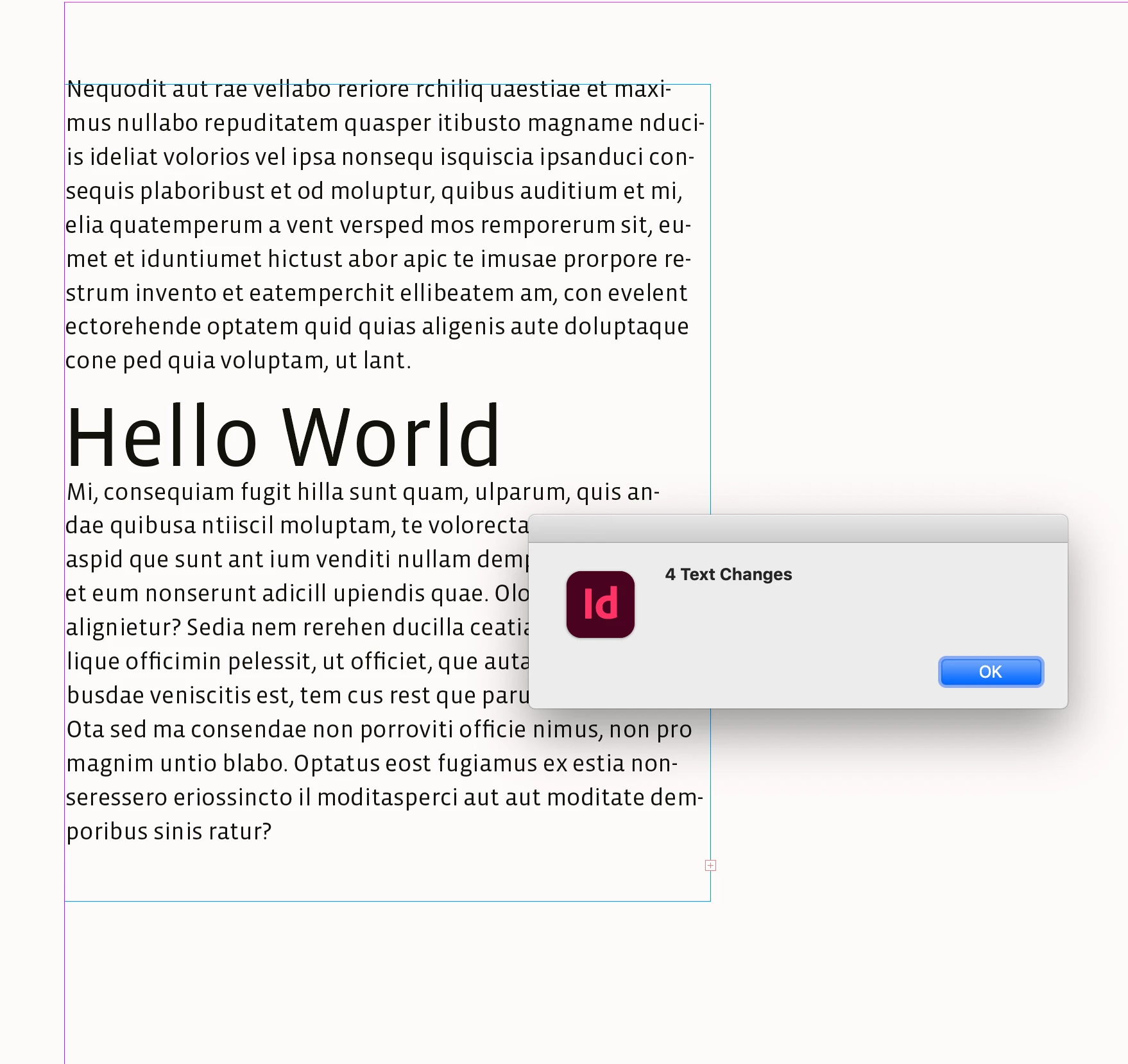

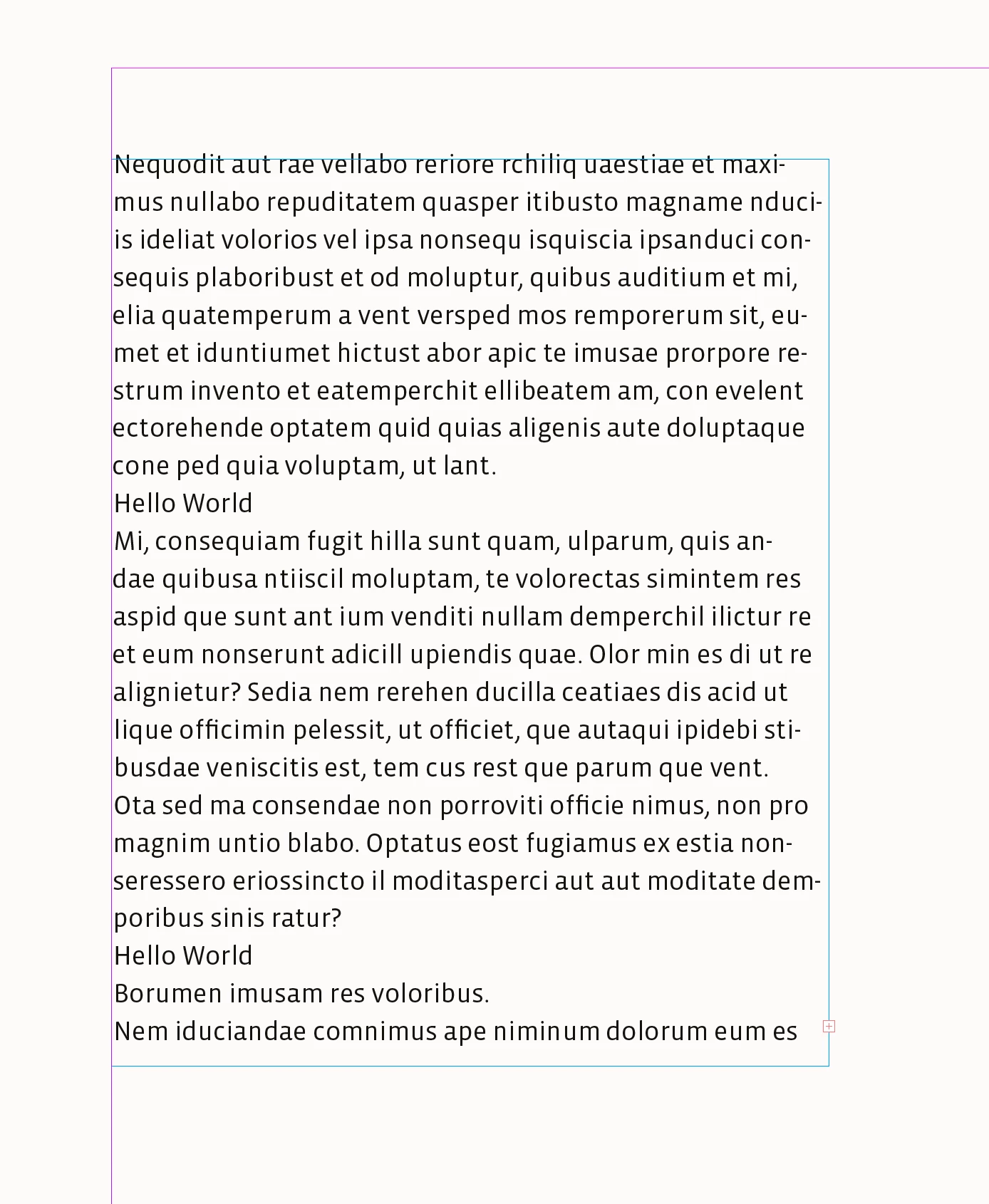

This returns an array of found text objects which you can loop thru. Keep in mind if there are back slashes in your Grep code you have to escape them—i.e., "\\{\\{[^:]*\\:[^}]*\\}\\}"   not   "\{\{[^:]*\:[^}]*\}\}"
var ra = grepSearch("Hello World");
//reverse loop
for (var i = ra.length-1; i > -1; i--){
	ra[i].properties = {pointSize:35, leading:40}
alert(ra.length + " Text Changes")
* Document Grep find returns an array of text objects
* @ param f the find grep string
* @ return an array of found texts
function grepSearch(f){
    app.findGrepPreferences = app.changeGrepPreferences = app.findChangeGrepOptions = null;
    app.findChangeGrepOptions.properties = app.findChangeGrepOptions.properties = {includeFootnotes:true, includeHiddenLayers:true, includeMasterPages:true, wholeWord:false}
    app.findGrepPreferences.findWhat = f;
	return app.activeDocument.findGrep()
