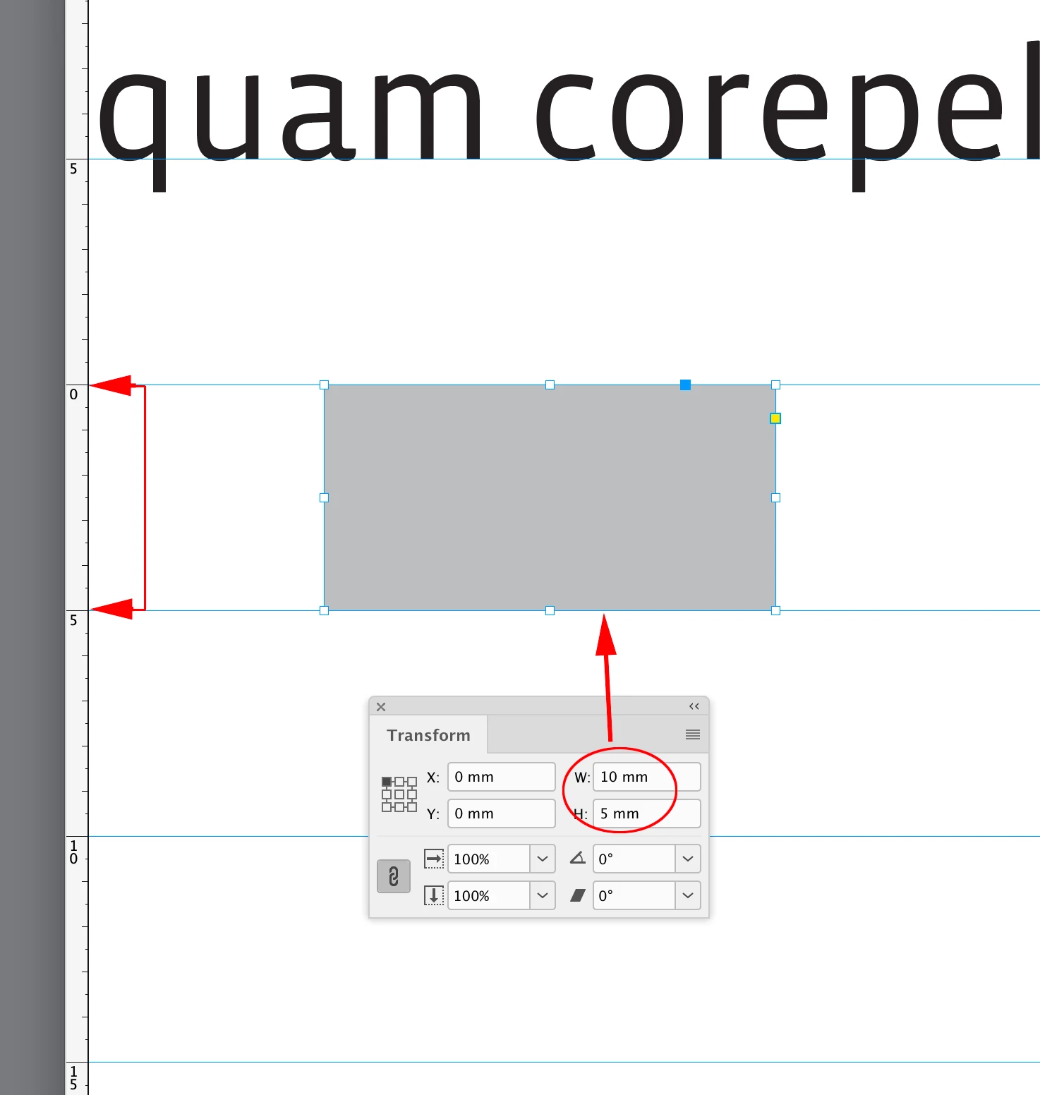

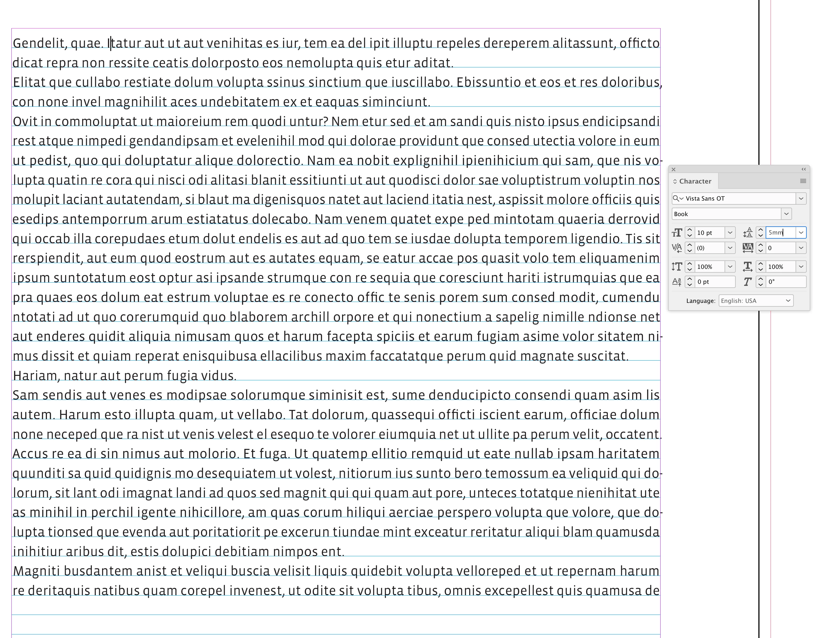

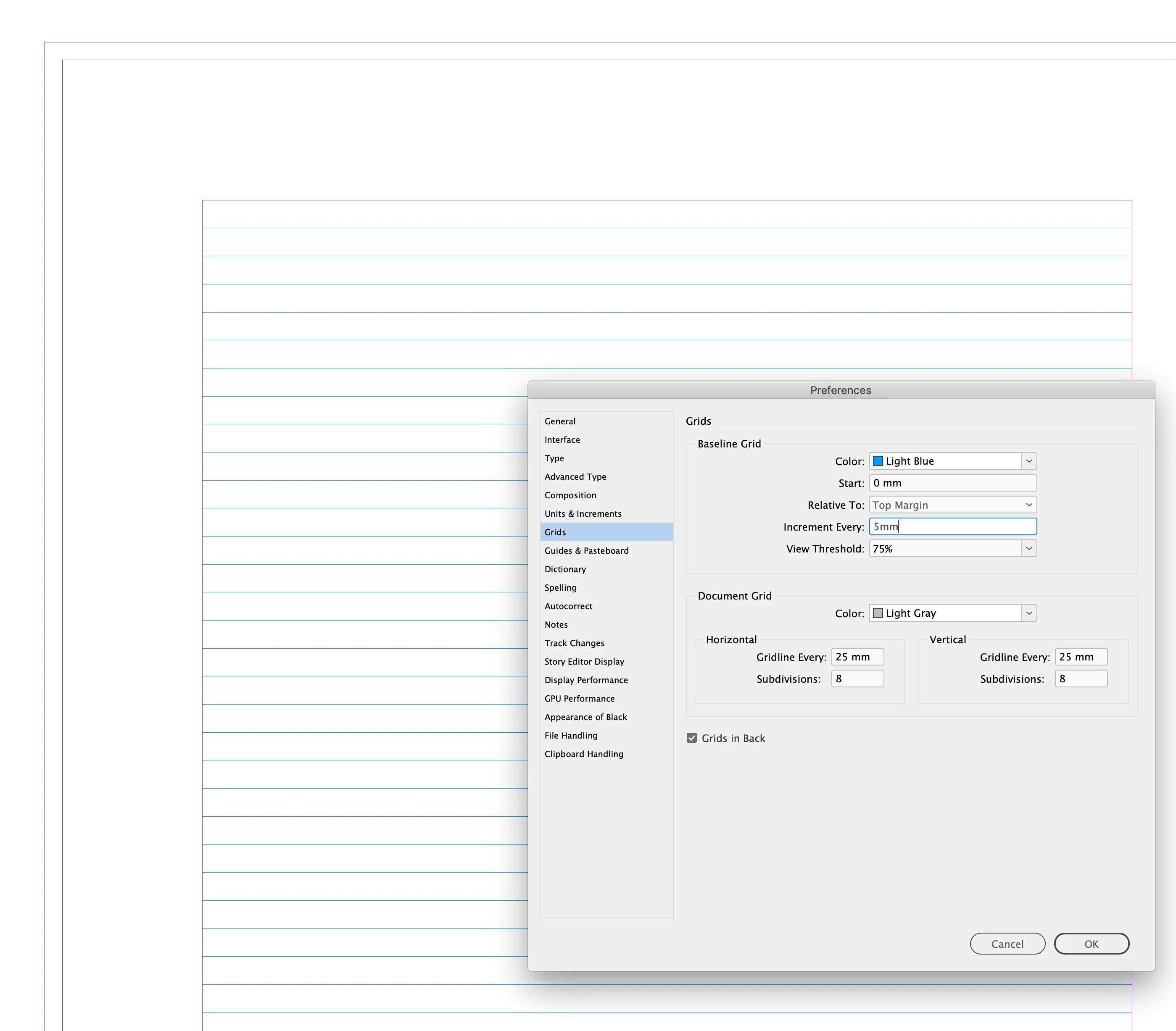

Hi @laurentc39824241 , it seems pretty easy to setup a baseline grid in millimeters. Here I’m setting up the document’s Ruler Units to Millimeters and the Baseline Grid to increment every 5mm starting at the margins:
If I set my text’s Leading to 5mm it aligns to the 5mm baseline grid as expected:
And a 10mm x 5mm frame aligning to the baseline with rulers set to Millimeters:
Mar 16, 2022 6:03 PM UTC
Ok but how does your type size or line height looks ? Weird decimals everywhere.
