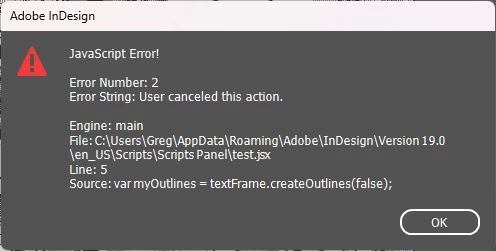

Here is a short script, made from a larger script I'm working on. When I run it, I get this dialog box:
Selecting "Yes" creates outlines as you'd expect, there's no actual problem here. Selecting "No" results in this error dialog box:
I believe I'm only getting this when trying to outline composite fonts. Putting the createOutlines() line inside a try/catch thing doesn't skip the first dialog box, but it does skip the second one (which means no outlines are created, which is not what I want).
How can I make the script automatically pick yes?

You can try setting the user-interaction level, which means that you bypass dialogs. You'll need a try/catch construct as well so that you can decide what to do with the error:
// Disable warnings
app.scriptPreferences.userInteractionLevel =
  UserInteractionLevels.NEVER_INTERACT;
try {
  var myOutlines = app.activeDocument.pages[0].textFrames[0].createOutlines(false);
} catch (e) {
  // Do something to deal with the error
// Don't forget to reanable them
  UserInteractionLevels.INTERACT_WITH_ALL;

Thanks, this works even without the try/catch. InDesign seemingly just picks "Yes," presumably because it's the default option.
