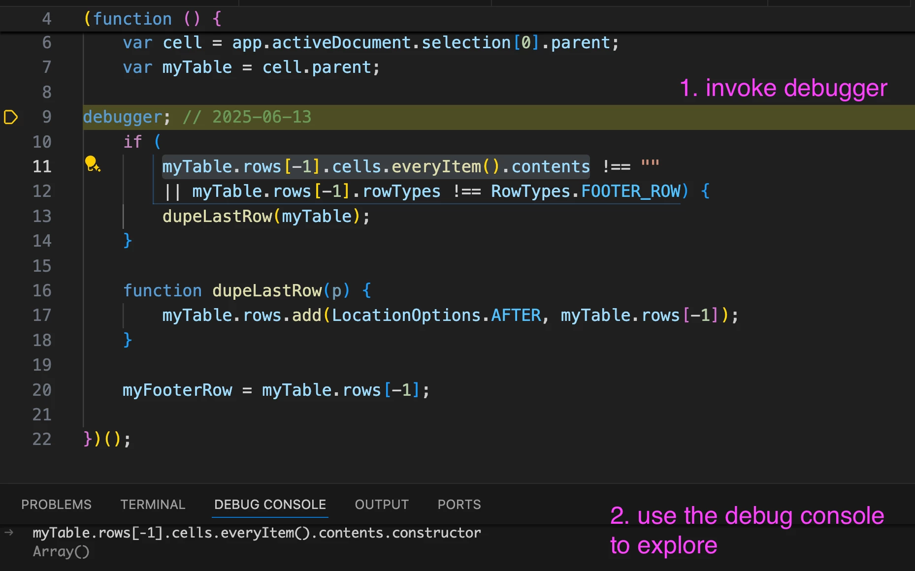

Hi @dublove, the problem here is that Cells.everyItem().contents returns an Array, not a String.
See this:
This is a screenshot of your code inside VSCode, using ExtendScript Debugger. I've invoked the debugger just before the "if" statement.
debugger;
Then I go to the Debug Console and type in some commands to interrogate my objects, in this case I enter:
myTable.rows[-1].cells.everyItem().contents.constructor
 And it shows me the result:
Array()
So this tells me why the if predicate isn't working (an Array is always not equal to a String).
You could try this:
if (
    myTable.rows[-1].cells.everyItem().contents.join('') !== ""
    || myTable.rows[-1].rowType !== RowTypes.FOOTER_ROW
Note also a typo in your second predicate.

m1bCommunity ExpertCorrect answer
Jun 13, 2025 7:41 AM UTC
See this:
debugger;
Array()
You could try this:
if (

dublove
dubloveAuthor
Jun 13, 2025 9:52 AM UTC
Hi m1b.
It seems to be working.
Thank you very much.
