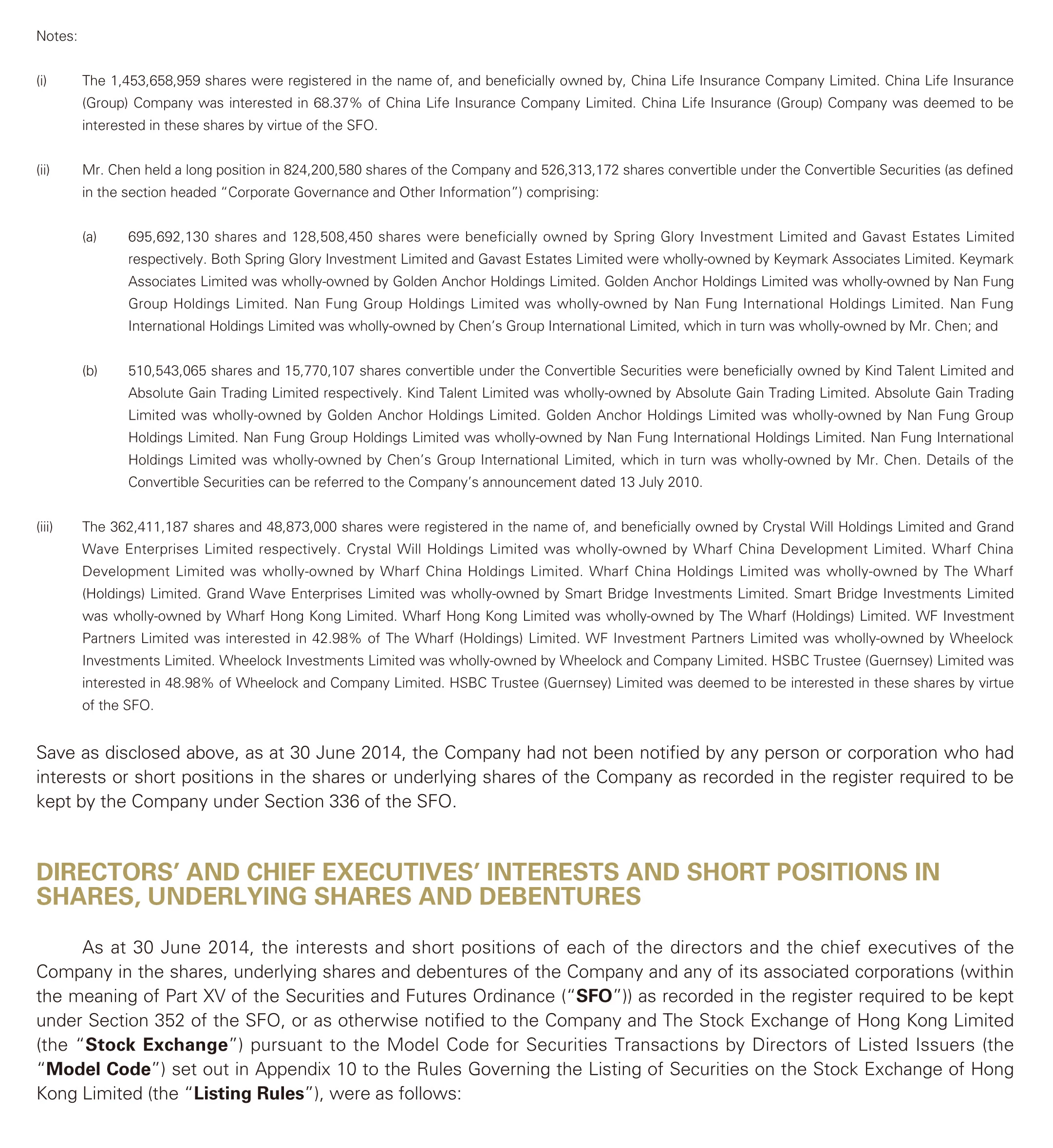

In three cases as below:
for example:
left indent:8mm; first indent:0mm
left indent:0mm; first indent:8mm
left indent:8mm; first indent:-8mm
How can I write a script to tell Indesign, wherever the text indent is, each time when I run the script once, the text can put just a step rightward, and “one step = 8mm”.

June 11, 2014
Hi, Trevor
Thank for your response,
I am working in financial print field.
I set left indent million times in a year, so I am so tire to remember the style name, and how many mm indent is, I am just lazy, so, I just want to easily run the script, if set indent 8mm, I run the script once, and indent 16mm run twice, and so on.
