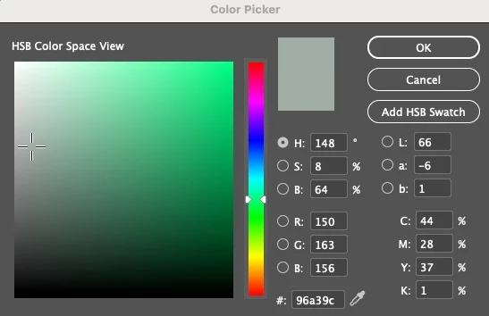

    I found this on a similar search and the idea to switch to LAB gave me the idea to try to click on the H I see in my ID color picker. And what do you know... it worked! The HSB options must have been a new addition as I don't see on the other posts below. But it's there now and now I can use the "normal" color picker. Not that monstrosity that was the original ID picker. Hope this helps fellow google sleuth.

    HSB arrived with InDesign 2021 in October 2020.
    https://www.tech4pub.com/2021/02/22/indesign-tip-use-hsb-values-in-color-panels-and-swatches/

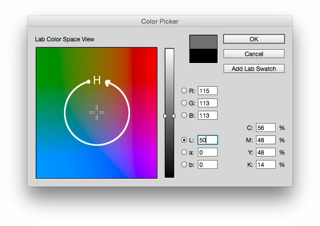

    Sep 24, 2018 9:00 PM UTC
    Also you might look at the L, Lab Color Space View, which is HSB like.
    With the L view, HSB's Brightness is in the right scroll bar, and Hue and Saturation are in the color field. it takes some getting used to, but it acts like an HSB picker.
    So the saturation goes from the center of the color field (neutral gray) to fully saturated at the outer perimeter:
    Then you find the hue by rotating around the center:
    Once you find the color's hue and saturation, adjust its brightness with the slider.
