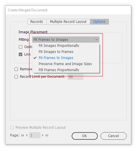

Did you tried any of these options?
November 13, 2017
Yes, but they don't give me the result I want.  For instance using fit frames to images, it will place via art bounding box leaving the number that should have been in the lower right corner towards the middle of the card then resizes the frame to the art bounding box. The fit image settings distorts the artwork.  I expected preserve frame and image sizes to work, but while it keeps the art the proper size it moved the location of it within the frame aligning it to the upper left corner so the word that should be at the center of the card is in the corner and the lesson number supposed to be in the lower right hand corner is shifted towards the middle.

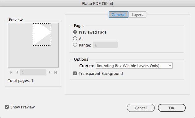

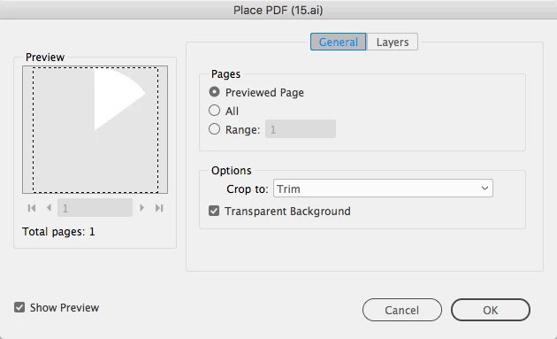

The way InDesign handles the placement of PDFs box size is "sticky". That is, if a PDF is placed into InDesign with the "show import dialog" options on, and then the setting is changed from art to trim for example, any other PDF placed from that point in time will then be based on that instruction.
For example, I've created a segment in AI that is to appear at the trim size, however the last PDF placed in the document was imported using the bounding box:
However, if I place the image again but hold my shift key upon clicking OK, I will see the show import options (this lets me see the dialog box on this one occasion instead of every time from that point forward) I can then change the setting and this will influence any images that are being dynamically placed via Data Merge to adopt the same trim-box instructions.
This applies too with a Data Merge, so if you want to change the edge box on the go, place any PDF into the base merge file and make sure the show import option is selected. Then check the data merge preview off and on and the images should adjust accordingly.
What this also means unfortunately is that if you want Data Merge to import one column of images based on bounding box, and another column of images based on trim size, this can't be done - there is one rule for them all.
