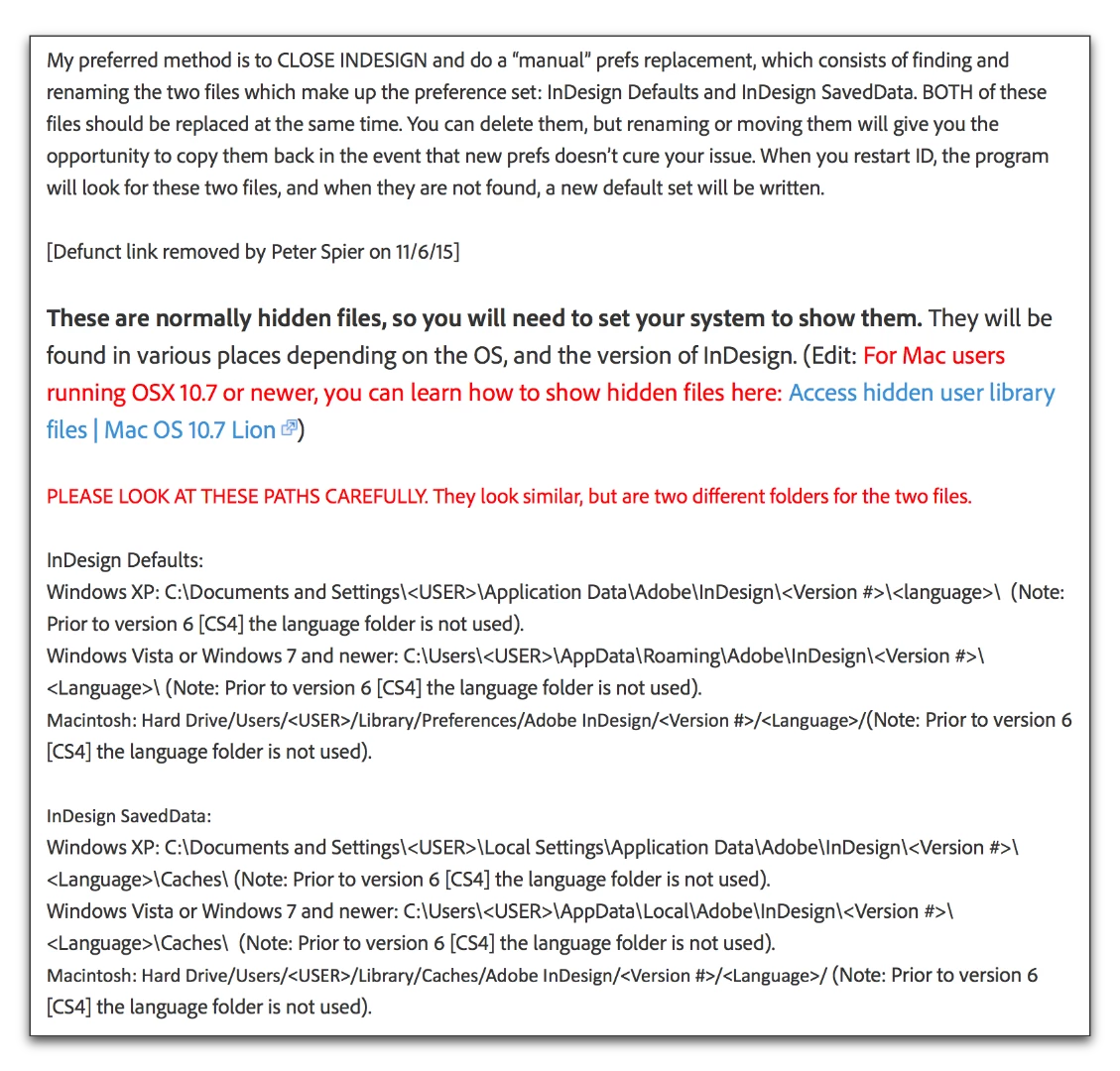

    And, Darrella, before you uninstall/reinstall, try the manual deletion of the prefs file from the article I posted. It takes less time:

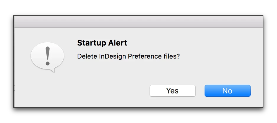

    Same as before, but it's always been a timing issue. Press down the keys as soon as you start InDesign. From my double-check on 2017, just now on my Mac:
    There's an alternative technique though, in this post:
    Troubleshooting 101: Replace, or "trash" your InDesign preferences

    January 19, 2017
    I've found it easier, with InDesign in the Mac Dock to press all four keys and then click the ID icon in the dock.
    This brings up a contextual menu that has "Open" under Options.
    No mad dash to cram my fingers on the right keys.
