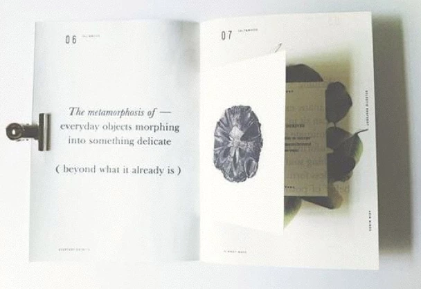

I am creating a brochure, with two page sizes. One, the master document (Bigger 10x8), and one, smaller pages (6x4) for additional information. In reality, when flipping through the book, the smaller pages will overlap the larger pages that are to follow. How do I demonstrate this, when I share pdfs with my client?
As of now, I have created two masters - One for the larger pages, and one for the smaller pages. I have alternated the page sizes, as they are supposed to be in the document. However, when I export, the smaller page on the right (pg no 3), for instance, will overlap the following larger page (pg no 5). But when exporting to a pdf, Indesign does not take this into account. Is there any way to do this?

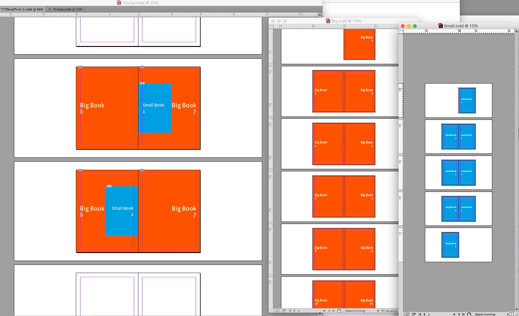

    You can place InDesign pages in another document the same way you can place an image. So for dummying you could make a new document with the same trim size as the large pages and place the large and small pages on the same page. Something like this where I created separate large and small docs, but you could do the same with a combined doc with different sized pages:
    At the left is the dummy where I've placed the 6-7 pages twice on spreads and then placed the small book's page 1 on top of the first spread's page 7, and then page 2 on top of the second spread's page 6. Once you've set up the dummy book all you would have to do is update the links if you make changes to the actual layouts and export the dummy spreads for the client.

    I don't think you can do with in a PDF by itself. PDF is not designed for this.
    To really give your client a good idea of the final appearance, you need to print out the PDF, trim the pages as necessary, and create a "dummy" sample of the book (as you've shown in the image). It would have a three-dimensional appearance which would resemble the final product.
