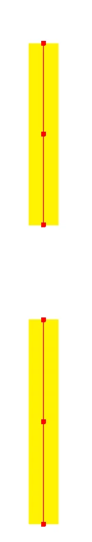

It's working for me in InDesign CC 2019. Here two images to show this. You must DRAG ALONG THE PATH over the part you wish to erase.
