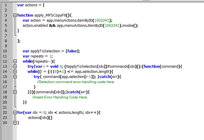

Using this block I can open the panel for the plug in. That is Step 1 from my previous post. Can anyone help with getting it to walk through the button clicks?

What about invoking the menuItem if the plugin added an entry ?
Loic
