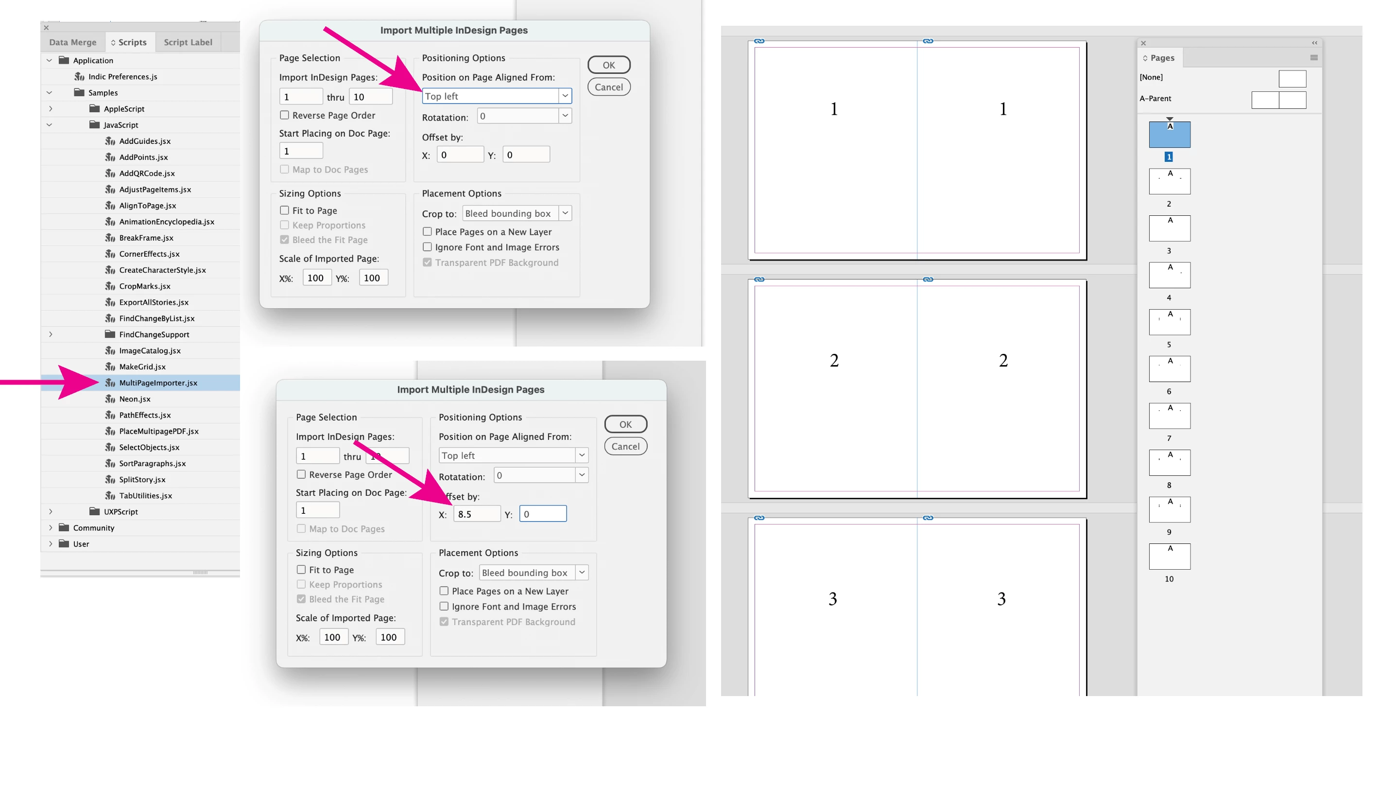

Luke Jennings3
Apr 15, 2025 4:33 PM UTC
Download and install the Multipageimporter script, hopefully it's still here:
https://community.adobe.com/t5/indesign-discussions/importing-multipage-pdf-indesign/m-p/13096715
Duplicate your InDesign file, delete all but page one, change the document setup to 17 x 11*
Go to Window> Utilities> Scripts> Multipageimporter> run the script (from the little fly-out menu).
Select your original InDesign file as the file to place, do this twice, offsetting the second place by 8.5".
*by duplicating the original InDesign file, as opposed to starting from a new file, you will retain any type preferences that could otherwise cause issues, also, any changes to the original file will appear on the new spread pages.

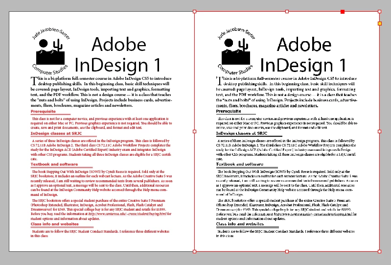

Robert at ID-Tasker
Apr 15, 2025 5:06 PM UTC
quote
By @Luke Jennings3
It doesn't work that way - if you duplicate INDD file - you're creating completely independent entity - in no way linked to the original INDD file - not affected by updates to the contents / formatting in the current file.
Page from the placed INDD file is treated the same way as if you would place PDF file - even if you change color of the font in the current file - it won't affect contents of the page placed from the duplicated INDD page:
On the right - page placed from the duplicated INDD file - copy of the INDD file placed back into.
