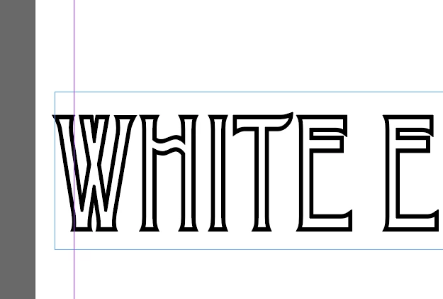

I have been trying to fill in desdemona font in indesign with just black (it's a hollow font). Can someone please explain how to do this. I would like to fill the below image and just make it black. It does not work to fill stroke because it is a hollow font. THANK YOU.

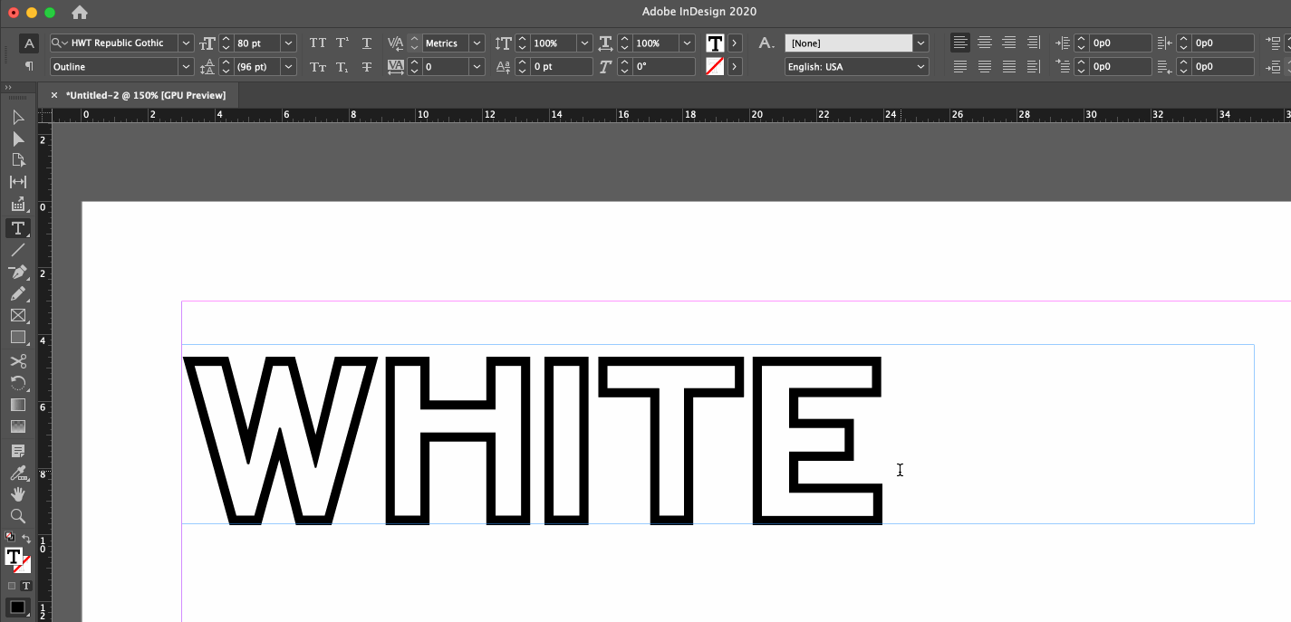

I don't have Desdemona—and don't want to download one of the free versions to my work computer—so I demo'd what to do with an alternative font that is available on fonts.adobe.com. Since I can't test this with your font, I'm not sure why it isn't working. The one thing I would double check is that you are selecting all four paths before Object > Paths > Make Compound Path.
One more option is to combine the four paths into two paths using Object > Pathfinder > Add, then bring the triangle path to the front, select the remaining two paths and use Object > Pathfinder > Subtract. (Subtract will subtract the front object from the back object so the stacking order is important—the triangle must be in front.)

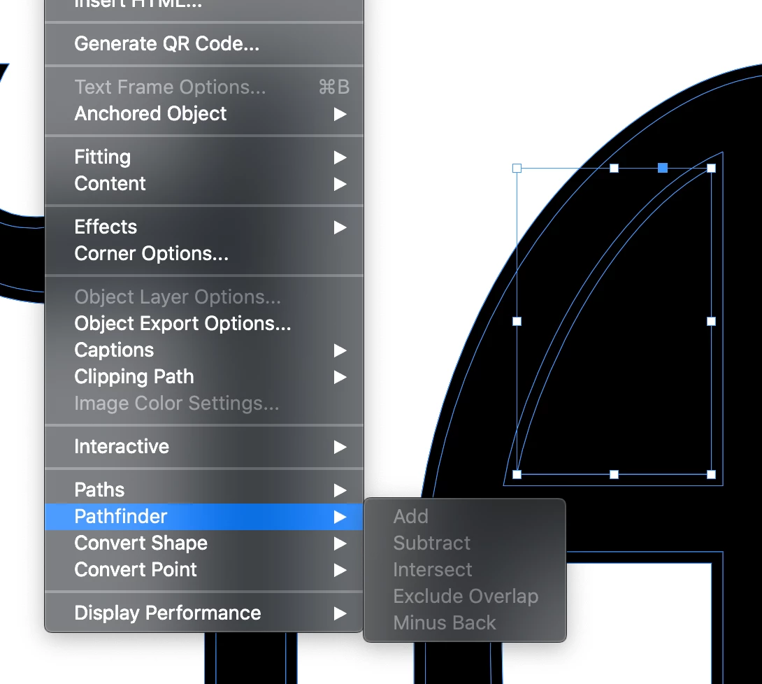

Your video is little, but it looks to me like your A has two paths—the outer path and the inner path. (I used a different outline font and I had four paths.)
Try selecting the A with the Selection tool, then shift click the outer A path—which deselects it and leaves the inner path selected—then choose Object > Arrange > Bring to Front. Then select both paths again, and choose Object > Pathfinder > Subtract.
~Barb
~Barb
April 9, 2020
Hi Barb, when I try that the pathfinder is greyed out. But I think I found a workaround where I can just click on the inside color and turn it white!

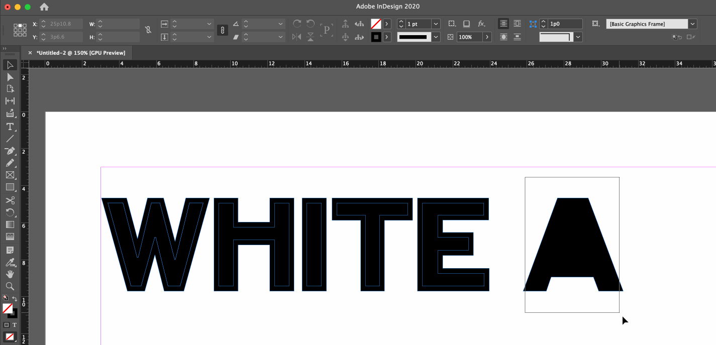

What I am showing you will work with the letters you have shown in the screen shot. Letters with counters (enclosed space inside an "A" or an "a") require an additional step.
Note: the text will not be editable after you create outlines.
  1. Select the text frame with the Selection tool.
  2. Type > Create outlines.
  3. Object > Paths > Release Compound Path.
  4. Select just the letters with counters with the Direct Tool and choose Object > Paths > Make Compound Path.
~Barb
April 9, 2020
Hi Barb, thank you so much! This worked except for the last step. It did not take out the inside black of the "a" of the Desdemona font in InDesign. Any help?
