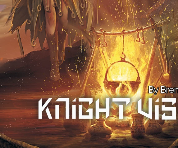

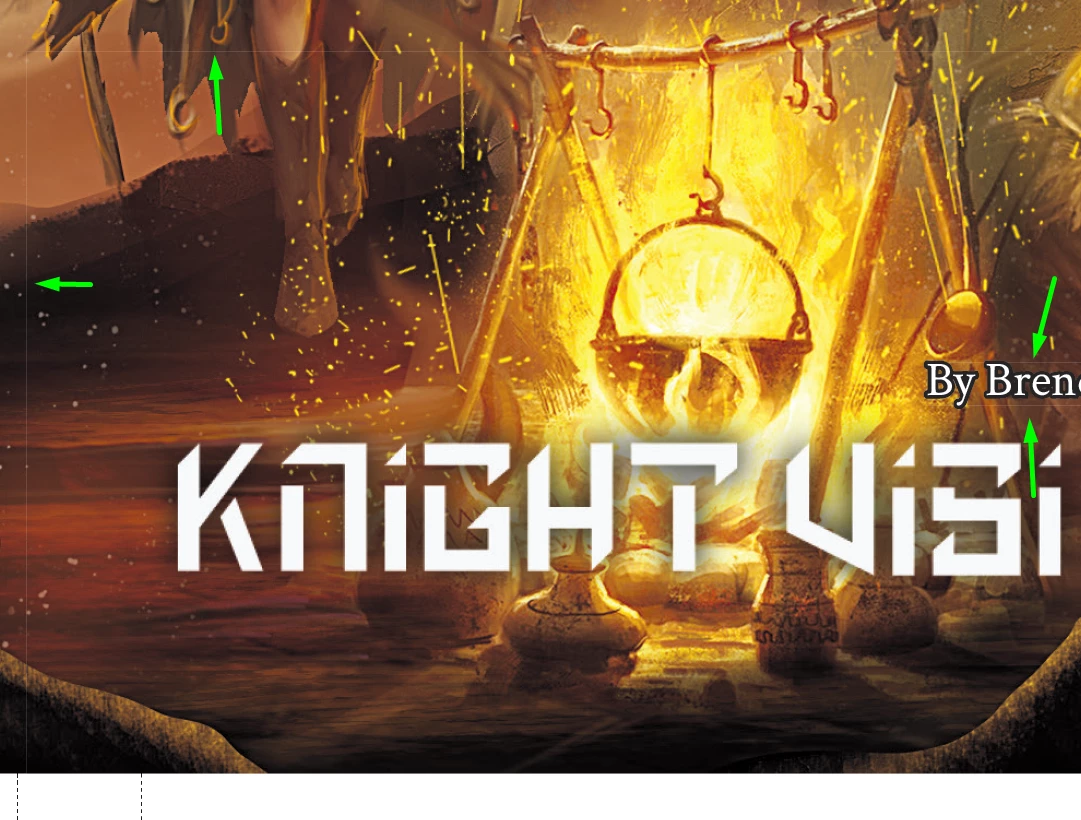

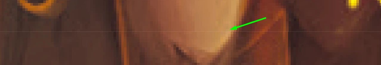

It's hard to see in the picture, but when I used export from InDesign to Adobe Print pdf format a few lines came through that aren't in the original when viewed in InDesign. One of these looks like a frame around text, the other I'm not sure. Why are these showing up?
Adobe Acrobat view of PDF
I have the line around one of the texts, but the other one doesn't even have a frame there.

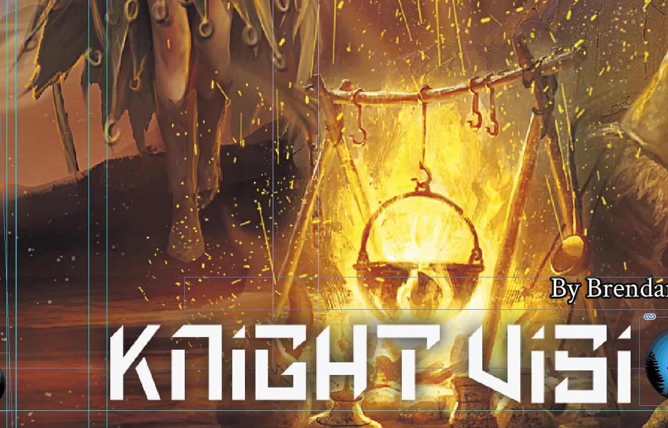

InDesign view of frames

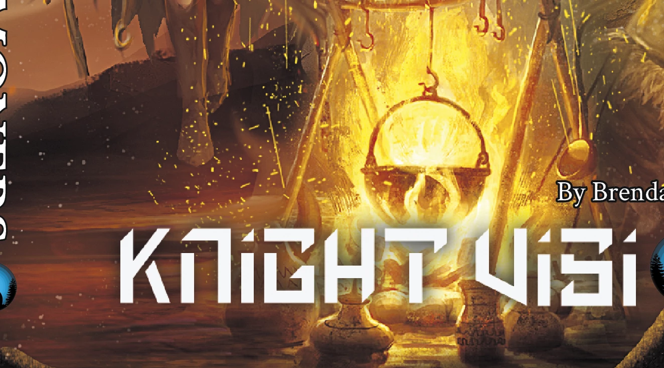

InDesign without frames
When I export it as a JPEG it looks fine.

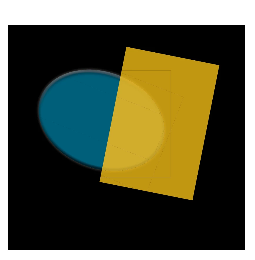

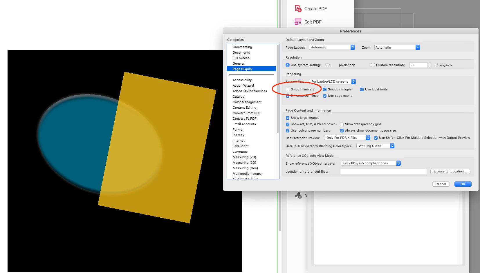

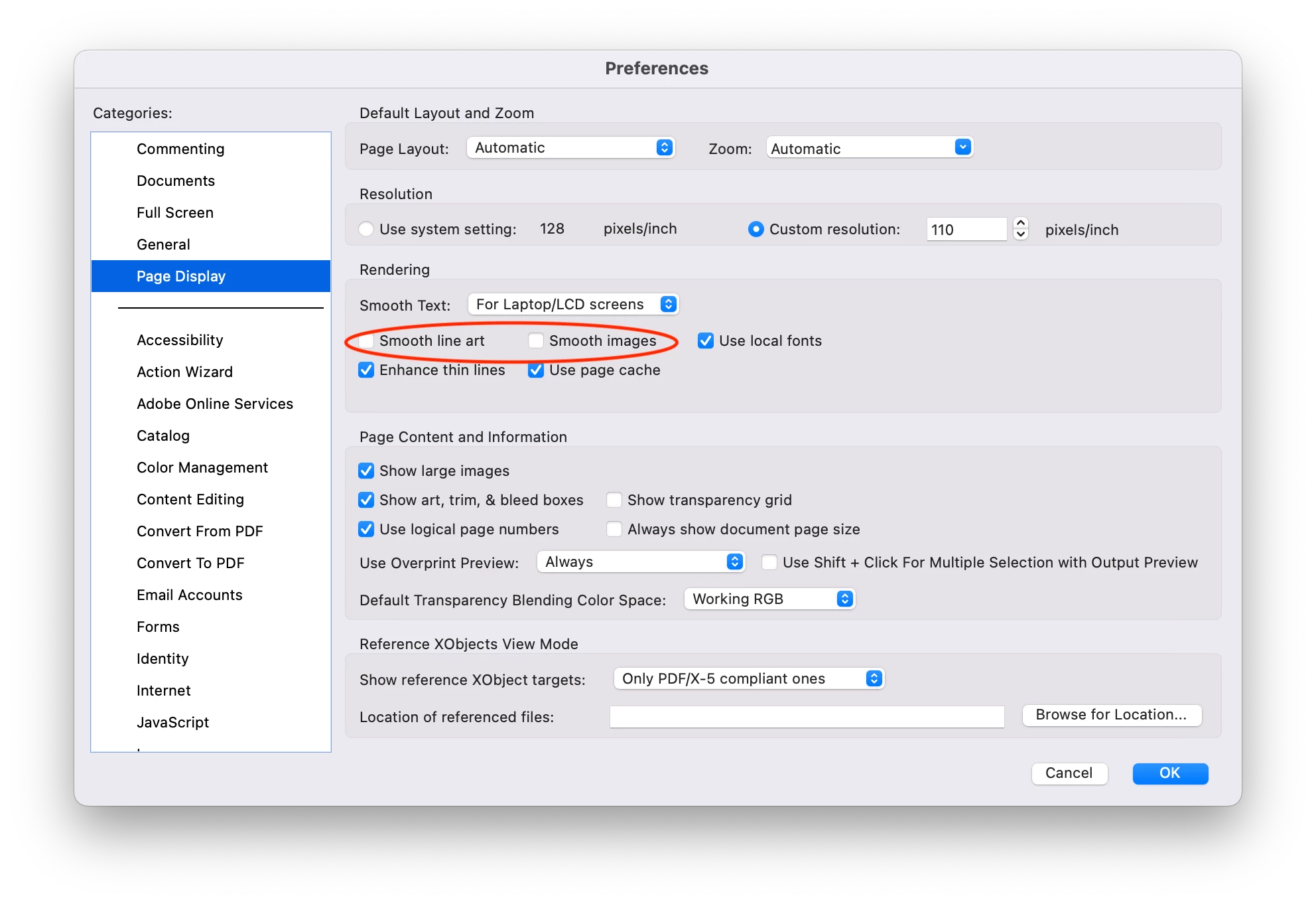

Hi @Brendan24111036dhr9 , Stitching artifacts are caused by Display anti-aliasing and would not print in high resolution output where there would be no anti-aliasing.
In Acrobat uncheck Smooth line art in your Page Display>Rendering Preference:

Hello @Brendan24111036dhr9,
Typically those lines are a non issue when it comes to printing, you can verify this by toggling a couple of preference settings in Acrobat. Go to Preferences > General > Page Display > Rendering and toggle the Smooth line art and Smooth images on or off from their current state. If the lines disappear it's just a dispay issue.

This is indeed true. When a high-end RIP processes these files, the stitched areas are rendered fine. You can see this yourself by opening your PDF in Photoshop and render it at 1200 ppi (with anti-aliasing off). The stitching lines should not appear.
However, this still doesn't address how people viewing it in other situations experience your great work. It looks crappy having stitching lines all over the place, so you are still better off exporting at at least v1.4.

@Mike Bro @rob day that did indeed remove it, thanks a bunch for the recommendation.
