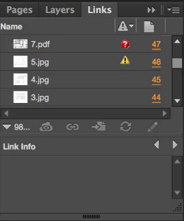

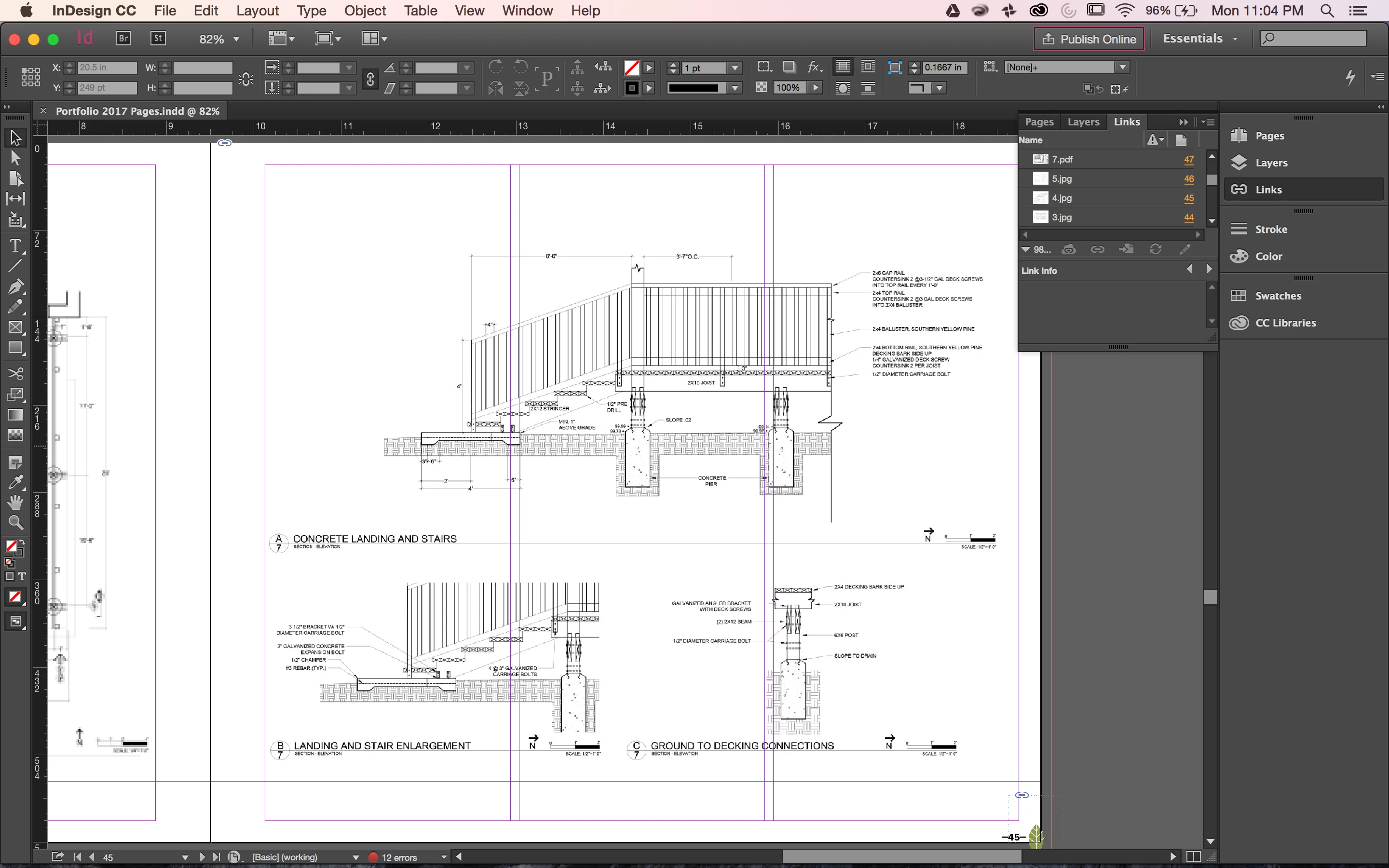

I am making a large important indesign file and I'm panicking because I have a USB that keeps disconnecting itself. I kept trying to get it to work and after several failed attempts it finally made the folder. How can I see if all the links made it over? Also, do the orange page numbers next to these images in the links panel mean that it can't find the file, or is it just telling me the page number?
Correct answer vinny38
Hi
As Steve said, Preflight panel will warn you in case of missing/modified links.
It can do much more than that, depending on how your preflight profile is set (overset text, missing font, and many more), so I would strongly recommend using that feature.

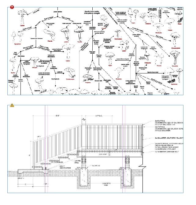

In addition, you probably have noticed it, I should add that your Links panel also does the job:
Red circled question mark for missing link, Orange triangle with exclamation mark for modified links.
Just like you did in your example : sort by status and warnings will show up at the top of your links panel.
Finally, these marks will also show up in your design (Normal view), just like here:
Regards
vinny

vinny38
vinny38Correct answer
January 17, 2017
Hi
Regards
vinny
