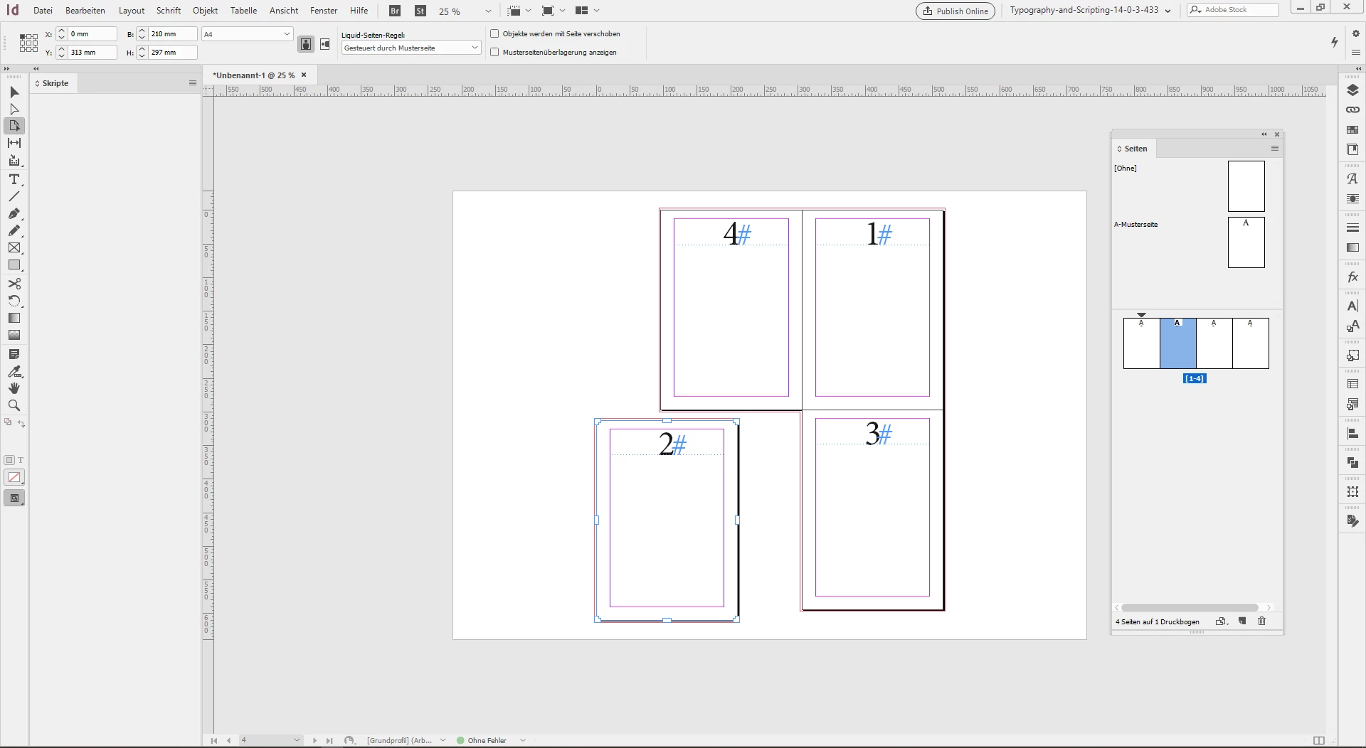

if you can live with a non-facing-pages document, you can do a four-pages spread and move all the pages around with the Page tool. Horizontally and vertically. You cannot do this with a document where facing pages are enabled and you have a spine. With such a document all the pages of a spread will snap to each other horizontally when moved.
Use the Page tool to move the pages around:

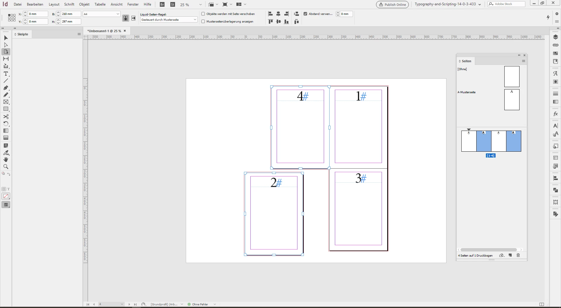

If you want to select non-consecutive pages at the same time, pages 4 and 2 for example, do that in the Pages panel when the Page tool is enabled. The pages will be selected in the layout of your spread as well. When two or more pages are selected you could use the Align buttons to align the selected pages:

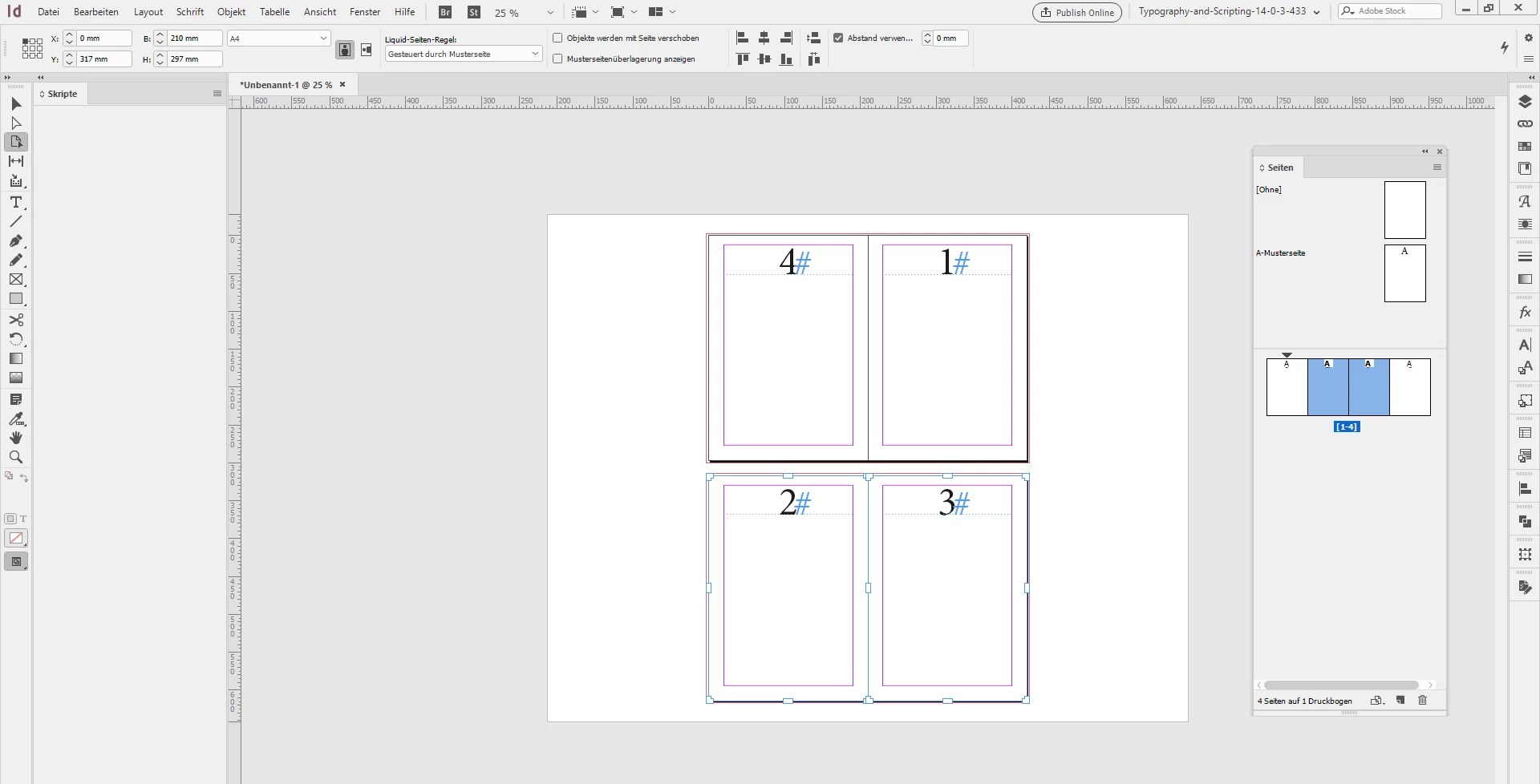

Use the Control panel to move selected pages to precise x or y values:

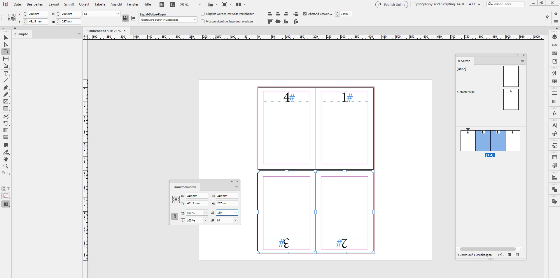

You may also have the need to rotate pages.
Can also be done with the Page tool and e.g. the Transform panel:

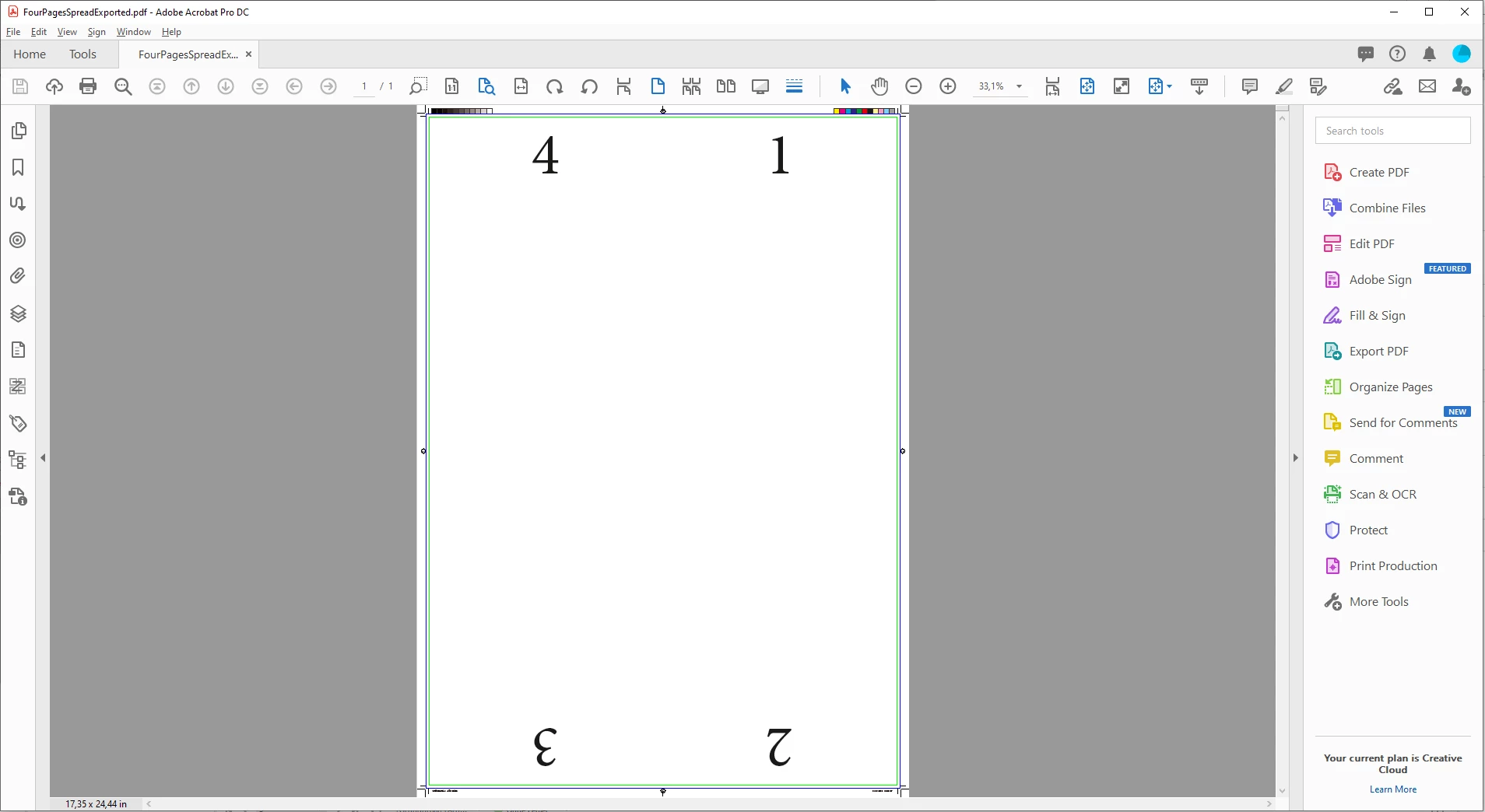

If you now export the whole spread as one PDF page you have all four pages like that:
