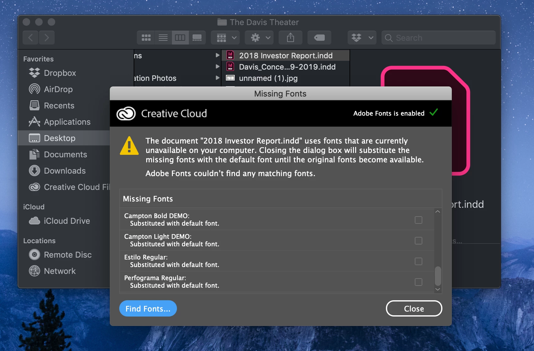

          2. "The document uses fonts that are currently unavailable on your computer. Closing the dialog box will substitute the missing fonts with the default font until the original fonts become available. Adobe Fonts couldn't find any matching fonts."

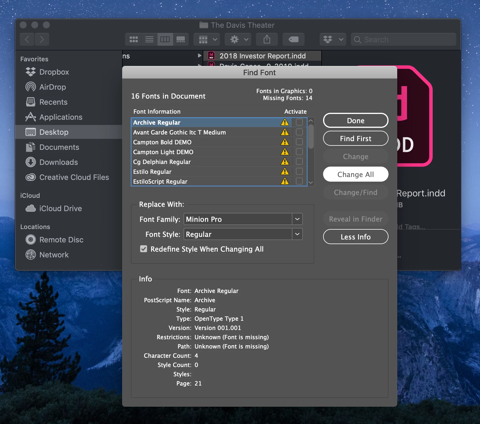

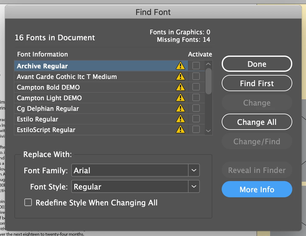

Great, so closing this dialog box will automatically substitute the missing fonts and I can open my file and deal with it manually. Or so I think. I click "Close" and this does nothing. The file just won't open. So I go back and double click to open it. I have to go through the first two dialogs again. On the second one, I click "Find Fonts..." instead of clicking "Close".

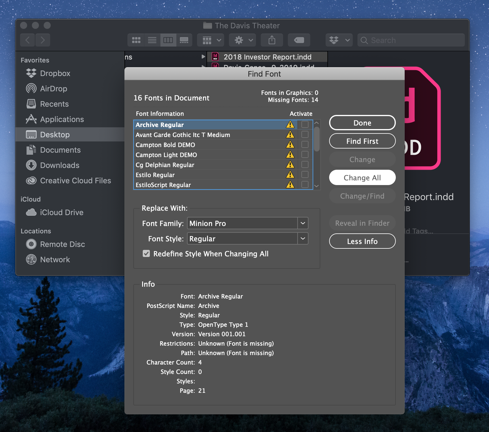

Next, I'm taken to a third more complex dialog box. I'd tried selecting each font and clicking "Change All." I do this for all of the missing fonts, changing them to Myriad Pro Regular. When I get to the last one, I click "Change All" and it refuses to disappear from the list. Okay fine then. I click "Done". I try to open the document and I'm back to square one.
What am I doing wrong? I feel like I'm going mad. Please see the attached screenshots for reference.

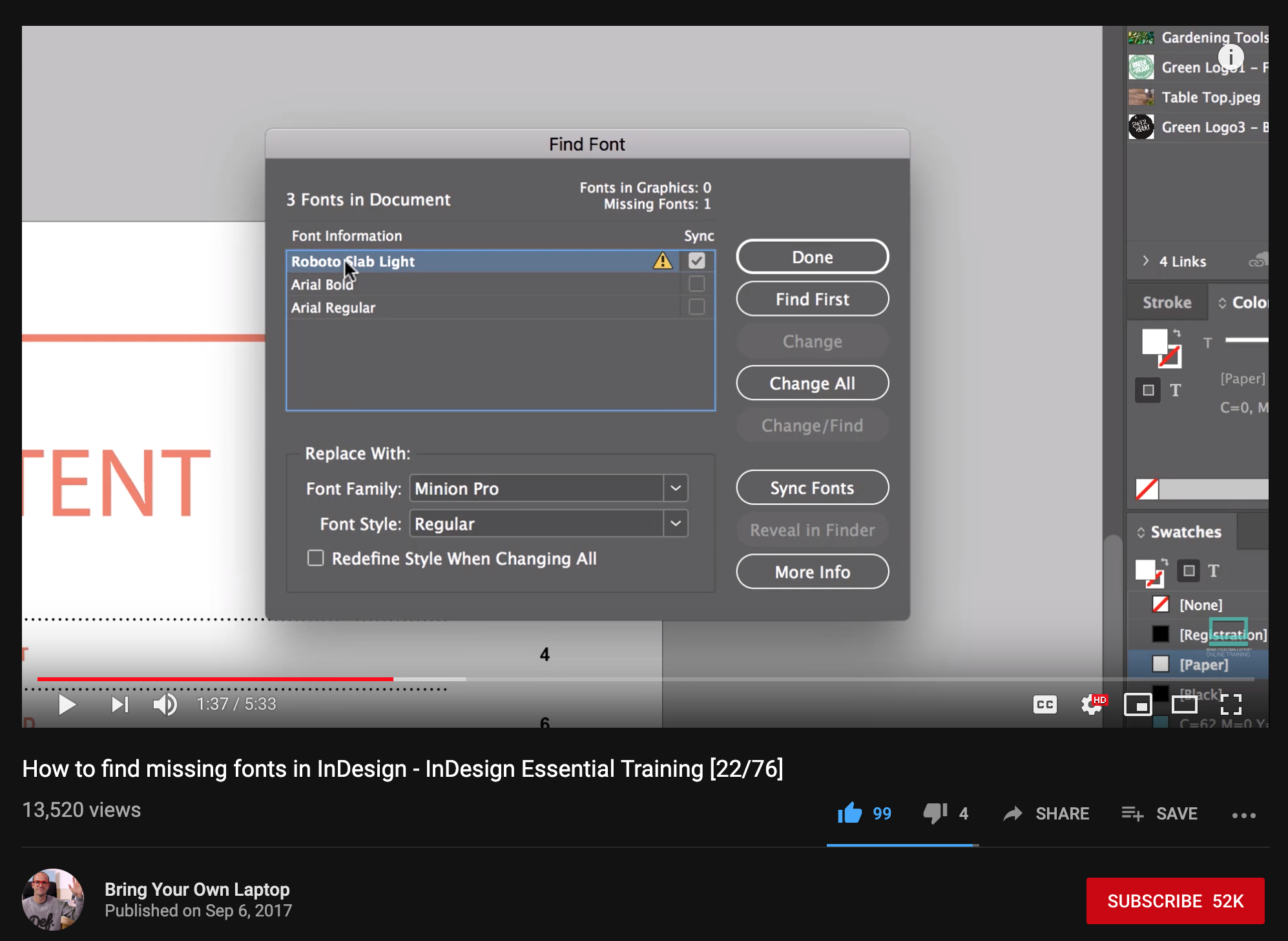

I watched a YouTube tutorial video and it was unhelpful. In the video, the instructor would get to the third dialog box and would have the option/ability to check the box under "Sync". See the below screenshot:
However, the problem is that in my third dialog box, the option to check the box does not exist. When I try to check the box under "Activate" it is unresponsive/refuses to be checked:

The Activate option is only for when the fonts are from Adobe Fonts, formerly Typekit, which could sync the fonts from the Cloud.
However, these don't appear to be so - you'd have to buy all the fonts, or get the font license to ensure you don't contravene the font license EULA.
Some of the fonts in your screenshots are DEMO fonts and may not allow export to PDF, as that would embed the font in the PDF, and a lot of Demo fonts don't allow embedding.
You need to acquire the fonts by purchasing them.
Or replace the font with another font on your system.

I have asked the person who sent me the InDesign file to also send me the font packs they used. If I install these font packs on my computer, will the InDesign file automatically link to them?
JonathanArias
July 13, 2019
you need the packaged files from whoever made that file. once you get those, there will be a folder name fonts next to the indesign file. install those fonts.
