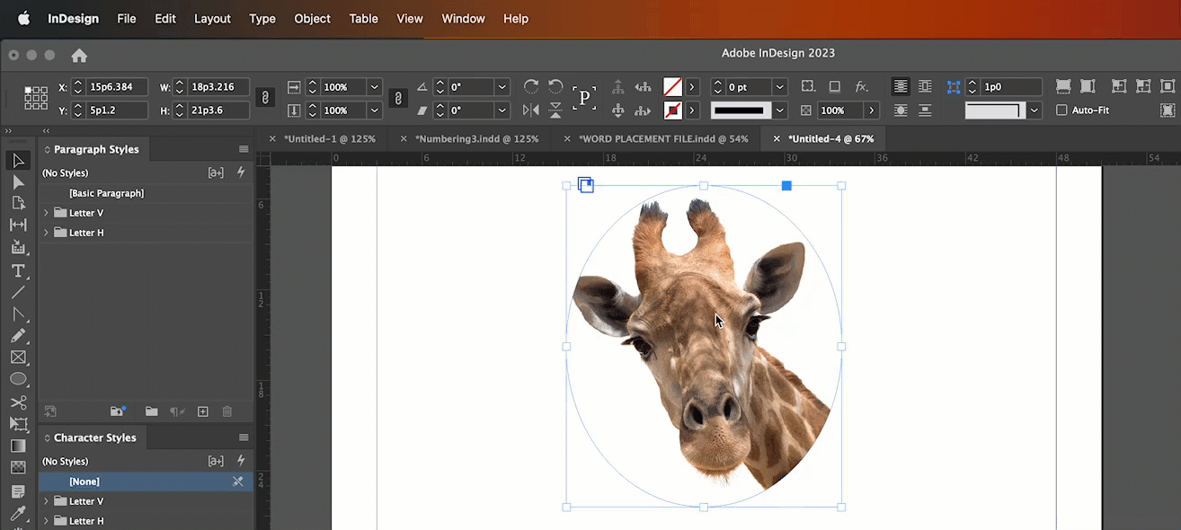

Enable Auto-fit in the Control panel to scale content and container together.

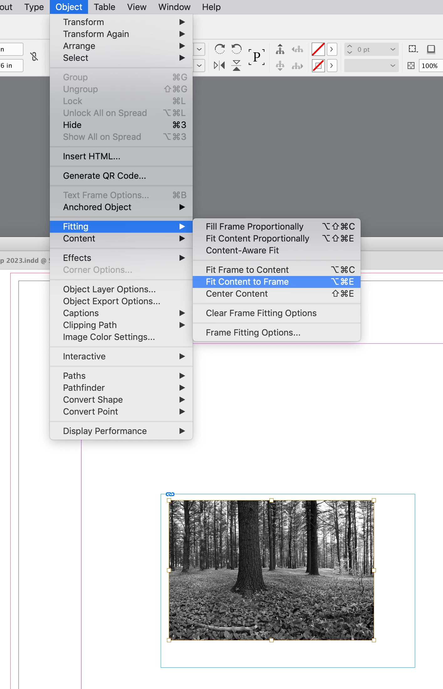

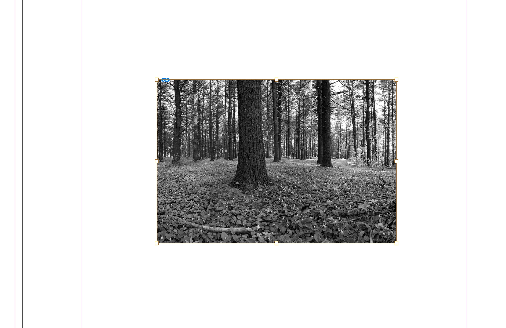

then I need to slowly adjust the image to fit the new container dimensions that it is inside
 Hi @paulg18077112 , Have you tried Object>Fitting>Fit Content to Frame, or Fit Content Proportionally?
March 2, 2023
Hi there
Thanks for the reply, but as I said, I had to use the pen tool to create the image container as I needed to remove the background of the image. The image container is the exact shape of the product and not just a square or rectangle. Using fit content to frame simply shrinks the rectangle image proportionally until it can fit inside the irregular shape drawn specifically for the product.

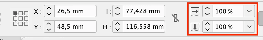

in the % field, type the desired value in mm (or cm, or inches, does not matter). This will resize content and container

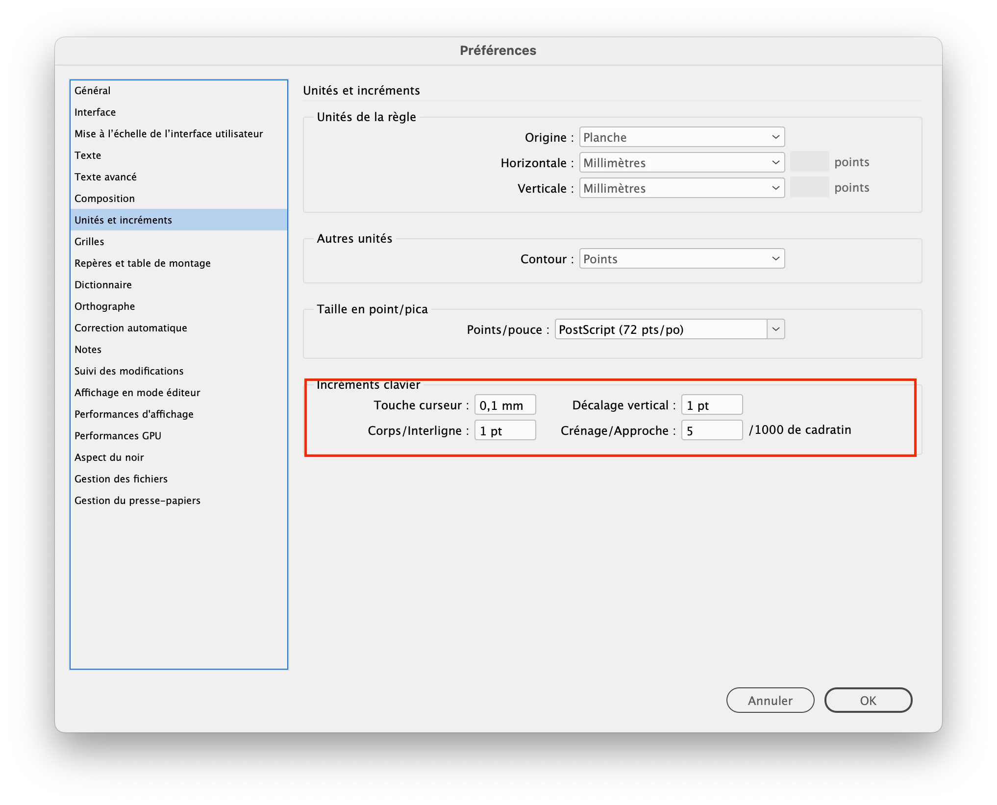

About your second question, you can adjust the increment values of tracking, leading and font size in the preferences > units and increment
