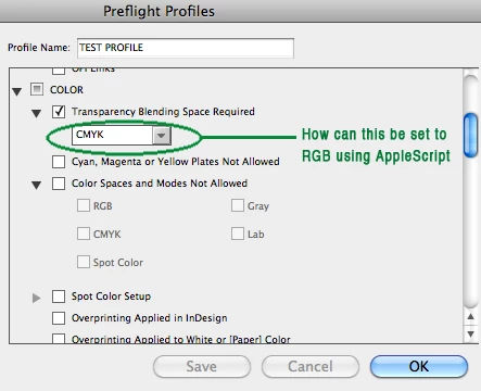

Hi Folks,
I'm attempting to write an AppleScript to create a Preflight profile in InDesign CS5.
I've worked out how to create the profile, give it a name, and set some of the properties using code similar to this shown below:
tell application "Adobe InDesign CS5"
          set profileName to "TEST PROFILE"
          set profileDescription to "This text describes what the profile does..."
          set newProfile to make new preflight profile with properties {name:profileName}
          set description of newProfile to profileDescription
          tell newProfile
                    set TrnspBlendOptions to make preflight rule instance with properties {id:"ADBE_TransparencyBlending"}
                    set flag of TrnspBlendOptions to return as error
          end tell
end tell
This code above will configure the settings as shown in the screenshot below:
My question is...
How do I access and set additional properties?
In this instance how do I set the colorspace to be RGB ?
Cheers, Rob.

There is no list of values given, so presumably, the easiest thing is to set the blending using the Preflight panel to the item you want, check what value it is, and copy that value in your script for future use.

Thanks for pointing me in the right direction Jongware - it's much appreciated.
I concluded that setting the 'data value' of 'rule data object 1' to 2 (for RGB) or 3 (for CMYK) it works succesfully.
Example as follows (albeit rather verbose):
         set profileRef to object reference of preflight profiles whose name is equal to "ROBS TEST PROFILE"
         set profileRule to object reference of preflight profile rules of profileRef whose id = "ADBE_TransparencyBlending"
         set flag of profileRule to return as warning
         set data value of rule data object 1 of profileRule to 3 (* RGB = 2, CMYK = 3 *)
     end tell
I just now need to work out an elegant solution to handle all other properties.
