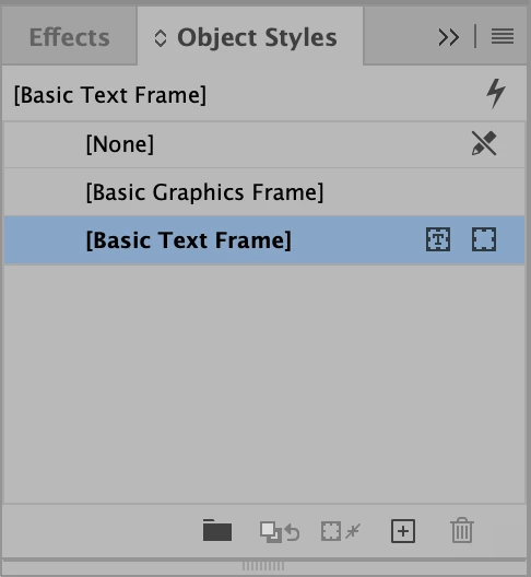

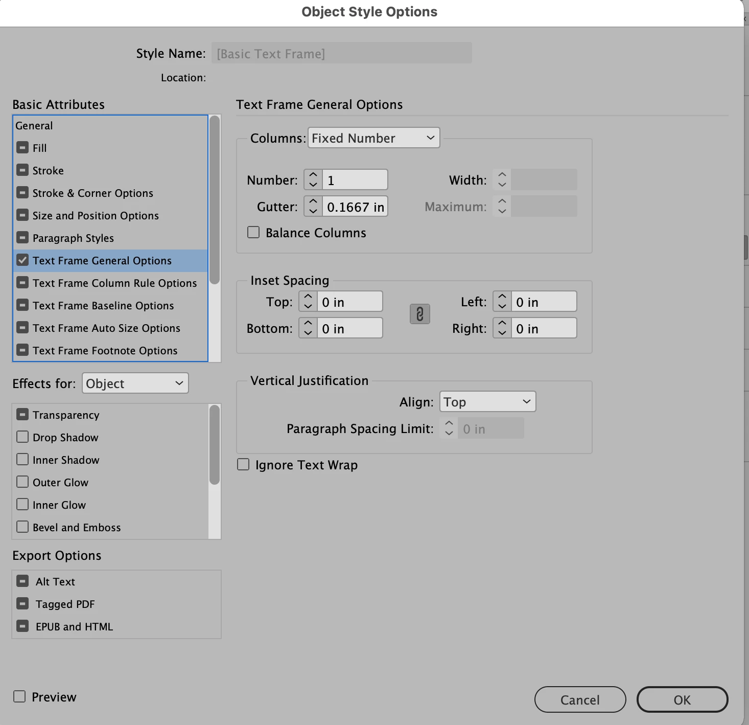

Steve Werner
March 20, 2021
I believe that you can do this by setting up the attributes of the "Basic Text Frame" in the Object Styles panel:
Double-click on it to see the attributes. Click attributes which are to be ignored by clicking on the Attributes in the list on the left from a "checkbox" to a "—" which means ignore.
Check the Text Frame General Options, and set the attributes you'd like to see in your default text frame.
NJ AuthorAuthor
March 21, 2021
Unfortunately this is not the answer, although I had hoped it was. It was set to "Align: Top" but all new boxes are set to center. And any changes here will affect hundreds (well over 500) existing text boxes too.
