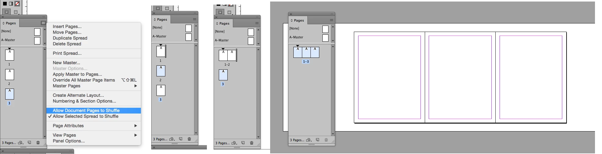

See screen shot below:
The first picture shows the turning off of "Allow Document Pages to Shuffle". The second picture shows a little bracket next to the top page. The screen shot wouldn't show it but what is actually happening is that I am dragging page 2 alongside page one in the pages panel until I get that bracket. When I see the bracket I let go and it now sits next to page 1 as in the third picture. The third picture also shows that I am dragging page three to be next to page two. The final picture shows all three pages as a spread both in the Pages Panel and in the document. As I said in my initial post you can work with it this way and when you need them to be separate pages again you can drag them back or just print the job as single pages. Just a word of note: If the job is printing as separate pages and has bleed then the pages will need to be dragged back to singles and the bleed must be added prior to printing.
Bill Silbert
August 15, 2017
You could set the document up as single pages (make sure that “Facing Pages” is unchecked in the New Document dialog window).
Then in the Pages Panel drop down menu make sure that “Allow Document Pages to Shuffle” is unchecked. Then you can move the document pages together as a three-across spread which you can later pull back down in the Pages panel when it is time for the printer.

Can't seem to make it work, or understand the process you mentioned.
The document is set up as three pages, not facing. I unchecked "allow pages to shuffle". I don't understand where and how to move the pages to a three-across single spread.
Thanks
digidandan
August 16, 2017
OK, I figured out that I can drag the pages next to each other and it did indeed make 1 spread with 3 pages. How do I get them back to three pages? They don't seem to drag apart again.
