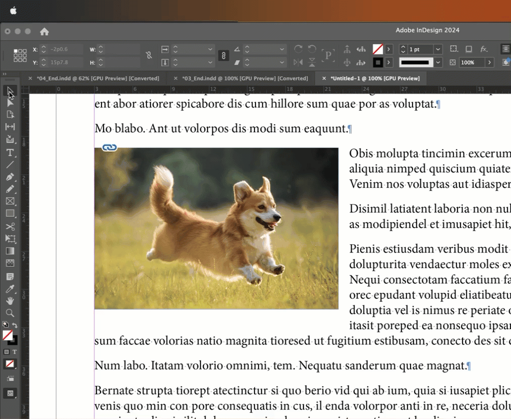

I can't seem to find a preference or even a description of this. When I create a text frame (or an image frame) it comes with a text wrap (which normally is fine) but if I try to resize the frame, instead of grabbing the edge of the frame it automatically grabs the edge of the text wrap indicator and drags that instead. I've tried holding down varies modifier keys to try to grab the frame edge instead, but nothing seems to work.
Is the only way to accomplish this to first turn off the text wrap, then drag the frame edge where I want it, then go turn text wrap back on? That seems so clumsy and inefficient I can't imagine that's how it's supposed to work, but I can't track down anything better.

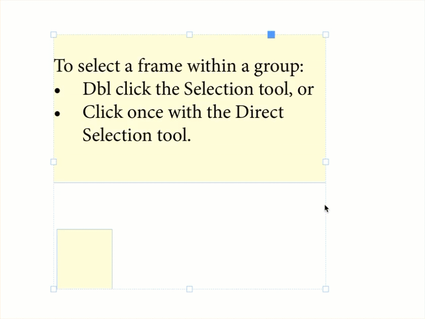

Ok, so that's the first mention of a group. And that explains what your tight crop is hiding from us—to select a frame within a group:
  • Dbl click the Selection tool, or
  • Click once with the Direct Selection tool.
If you click the frame with the Direct Selection tool to isolate it in the group, then you will have the Direct Selection tool active and dragging the edge will move the text wrap boundary. This is what you just showed us: note the white arrow with the / next to it—that's the Direct Selection tool .
If you double click the frame with the Selection tool instead, then you will have the Selection tool active, and dragging the edge will change the frame width. This is the issue.
~Barb

I didn't say it was always in a group, just at times it "may be grouped." Yes, Mr. Gifford mentioned the double-click method of selecting items within the group. The video clip was made before the explanation about double-clicking with Direct Select tool. I was asking if there was a way to select the frame edge with the Direct Selection tool (instead of the wrap)... a modifier key combo or something. I gather there is not. Thanks for your help.
