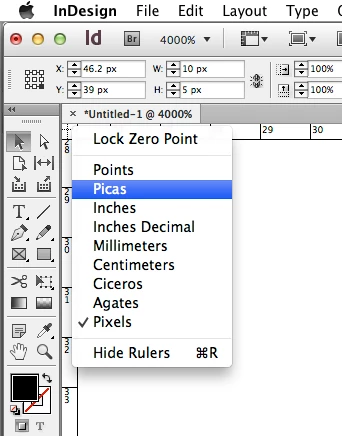

How did you go about changing the units of measurement for the document? If you aren't you should try (with rulers on) right clicking on the box in the top left hand corner where the rulers meet and selecting a different unit of measurement. I usually work in picas.

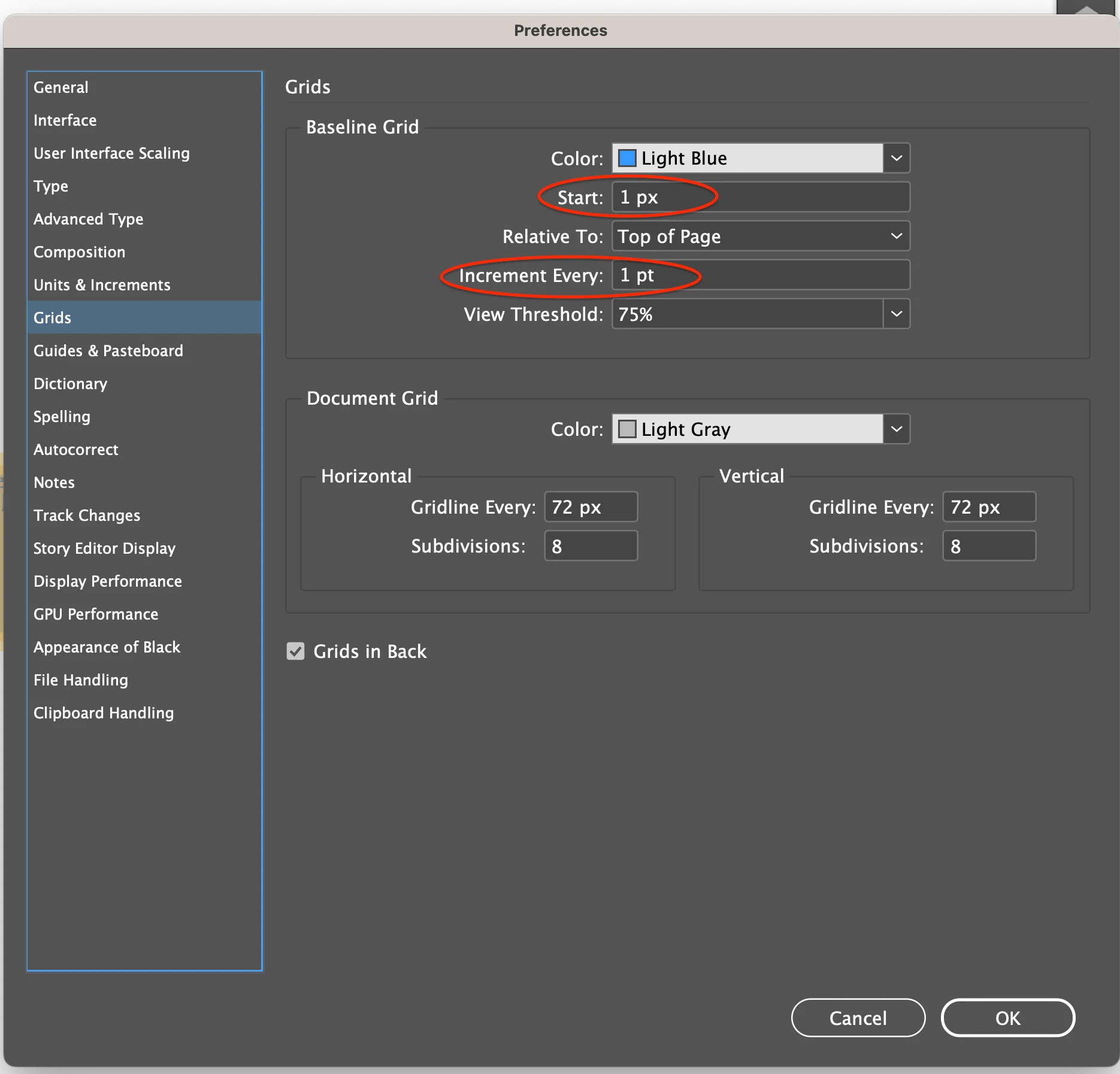

I read through this thread and tried everything with no success... so I took a deep dive into the InDesign menu and eventually found a solution to this issue:
Edit-> Preferences -> Units & Increments
Then play around with the settings under Keyboard.  Setting everything to 1 or 0p1 worked for me.

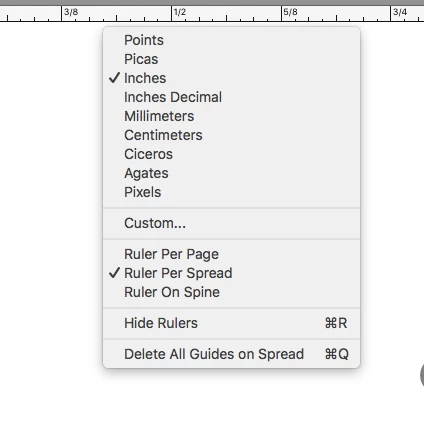

Also one thing I just realized is that you have to change both the horizontal and vertical axis increments. I learned this trick where you right click on ruler and can change increments in illustrator, indesign, and photoshop without going to preferences. But yeah, changing from pixels to inches solved it for me also. thanks
