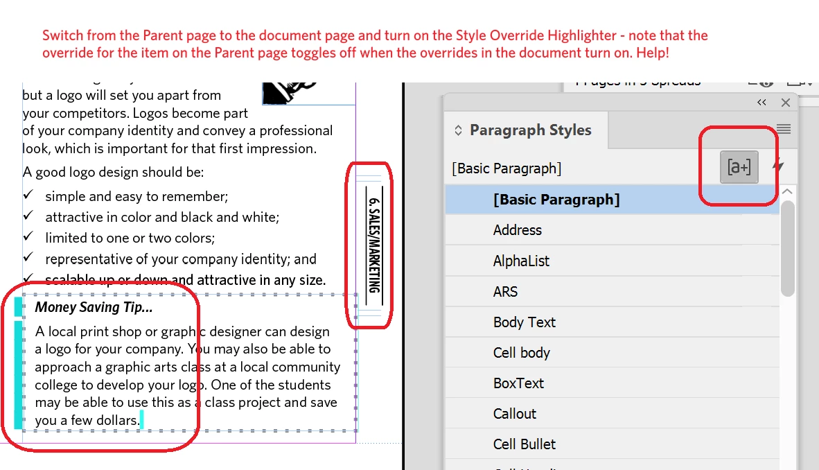

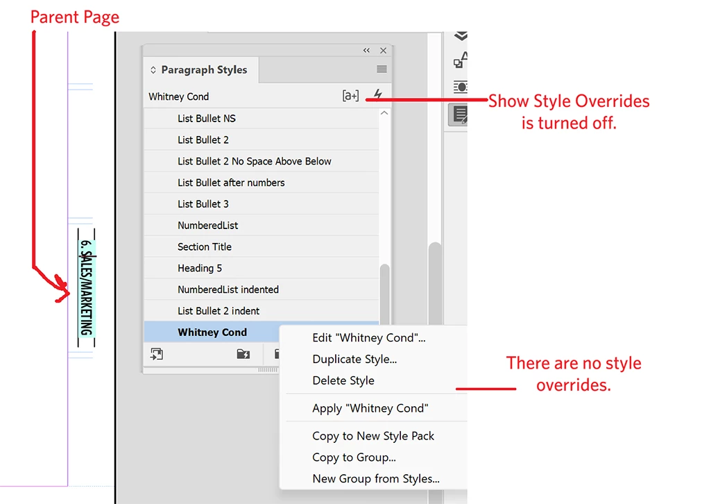

Jul 22, 2026 11:29 PM UTC
Well, this has raised its ugly head again. With the last update of InDesign (21.4.1 x64), I am having the style overrides highlighted only in one chapter of a book I’m editing. Yes, I can turn them off, but that action turns highlighting on in the parent pages, which do not have any style overrides. If I turn the highlighting off on the parent pages, it turns on in the document pages.
Yes, I know that the highlights don’t print, but I don’t want the clients to freak out. :)
Does anyone have any clues?
