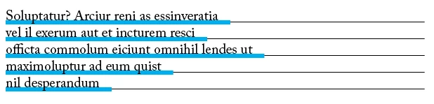

    The method of Jongware is almost working... Only it skips the middle lines (5th sentence):
    Am I doing something wrong?

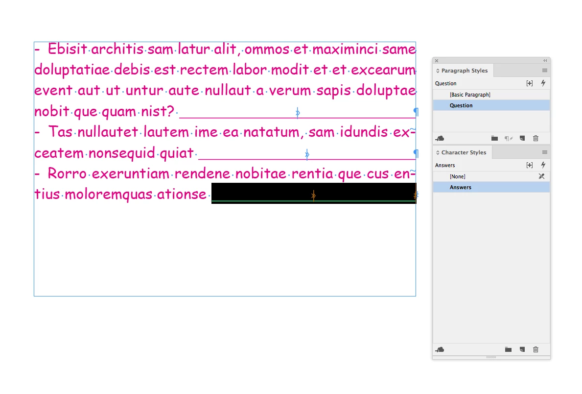

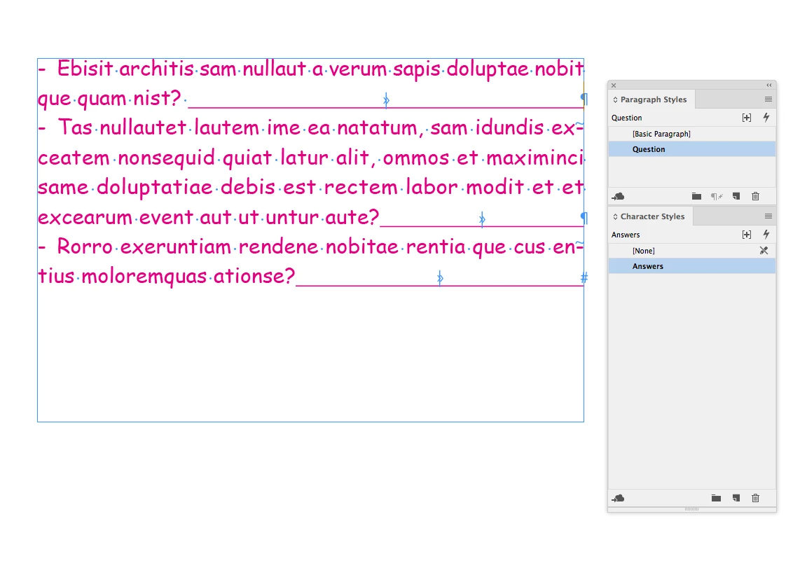

    rob day
    December 23, 2018
    Why wouldn't a Right Indent Tab (Shift + Tab) with an underline character style work?
    If you have to edit the text the underline will adjust itself to the new text:

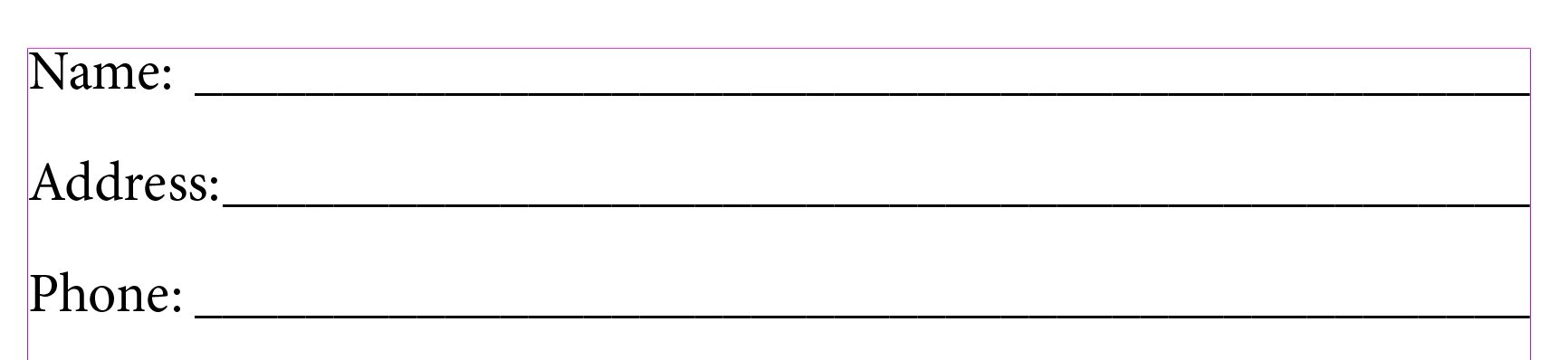

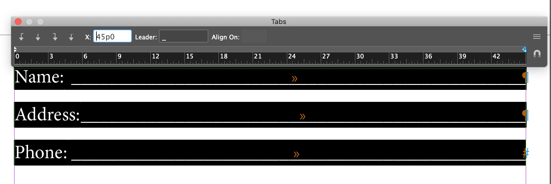

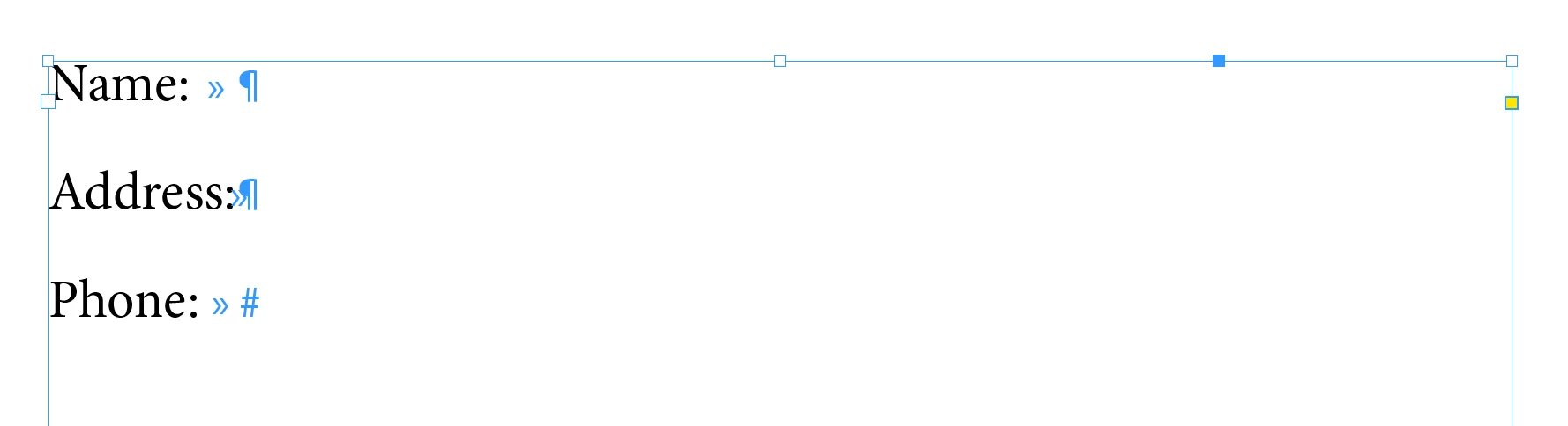

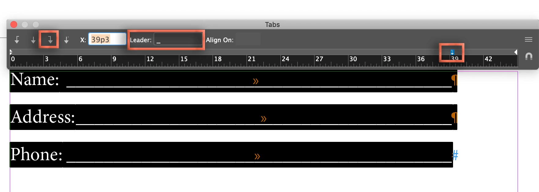

    Hi srthsthaeht:
    I just use a right-align tab. Press tab at the end of each line.
    Select the text, choose Type > Tabs. Add a right-align tab towards the right, then define an underline (shift+hyphen) as the leader.
    If desired, drag the tab over to the right margin.
    Results (with and without hidden characters visible):
    ~Barb

    December 23, 2018
    I use Barb’s method with an underscore and right-aligned tab because I have:
    First Name ____________________ Last Name ________________
    City _________________State ______________ Zip _____________
    Can you guys make one of those other methods work for this?
    ~ Jane

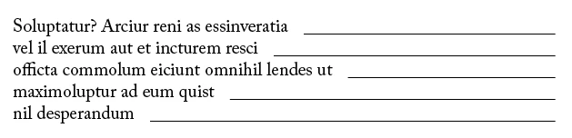

    You can use Paragraph Rules for this.
    Set the Rule Above to 0.5 pt, Text Color, Column Width, with a modest Offset of about -0.5mm to move it slightly below the baseline.
    Set the Rule Below to 3 pt, [Paper], Text Width, with a Right Indent of -2 or -3mm (per your own preference), and an Offset of 0mm. This is to cover up the full paragraph Rule Above for only the text width. To check if it correctly covers the other rule, enable Preview and set its color to something clearly visible, such as Cyan. Use Offset to move it slightly up or down, or simply enter a very thick weight (well – better not make it thicker than your text is high).
    When you get it to look like this
    set the Rule Below color to [Paper] and enjoy your Fully Automatic entry lines:
